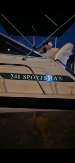

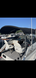

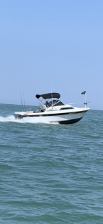

Maiden voyage went perfect!!
ejnichol
May 28, 2002
181
Read through most of the thread. Looks really good. Better built that when it left the factory.
I could never find the drive to do this but my hats off to you for seeing it through.
39,257
You now have a boat you can be confident in.-----Likely near $100,000 to buy a 25 footer like that new these days.-----Certainly worth the effort I think.-----Go get some walleye on Erie.
