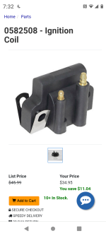

Your link didn't really work but the omc stock ones are only $35. Thought they were more so that's good.
