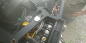

I unscrewed the 2 yellow wires (one yellow with white line) and motor did not start, then i reconnected them and now am still left with no spark. That's the 2 wires, one side to stator one side to plastic block tired to rectifier. I removed them at the screw on the block.

Those wires purpose is to charge battery and a defective rectifier can cause stator to overheat. Need to ohm and DVA test stator as if might have went ahead and failed. Or timer base as they can come and go depending on temp.

Ok, so its hard to tell what the actual color of the wires are, but look like orange/white line (O/W) and like a pink or off white with black like (W\B) then there is yellow/white (YW) and yellow (Y)
YW touched to Y has 2.1 Ohms
O/W touched to W/B has 586 ohms
When I attempt to do the peak test between O/W and W/B I get 0.
When attached and key is off, YW to Y reads 0 volts with key on reads 12V.
What else should I check? Or does this flat out say its the stator? Or does it say the stators shot and possibly bad rectifier? Or should i check into the timer base testing still? Thank you.

Should not be any voltage on the yellow and yellow/grey stripe wire except when engine flywheel is turning.

As stated no voltage on yellow wires from stator unless flywheel is turning and this will be AC voltage. Check voltage on brown wires from stator to pack .

The brown wires give me 0v, at all times, and are the wires the have 589 Ω. And if those 2 yellow wires are connected to the rectifier, with the key on, they read 12v between them. This suggesting the rectifier is bad? I will redo the tests when then storm passes just to make sure.

As stated beforehand above, if you get DC voltage with key on engine off on either of the stator wires then the regulator/rectifier is bad.
The diodes in the device are one way gates, positive AC voltage only should be rectified towards the positive end of the electrical system. Positive Voltage/current that attempts to go the other way back to the AC stator should get blocked.

The only wire to have 12V should be the red on rectifier, the yellows will have no voltage with key on....if so as posted the rectifier is toast. Your ohn spec is close for th brown wir and with leads hooked to the browns only , cranking you should see 160-400V on meter with DVA adapter.

I do not have a meter with a peak freeze, but with meter set to read up to 500v, only gives me a visible result of 86v from brown wires while cranking. Not, sure if this is accurate to the DVA test. All the numbers on the blue line highlighted below come back in spec, with the exception of the brown wires, which as stated question my method.
