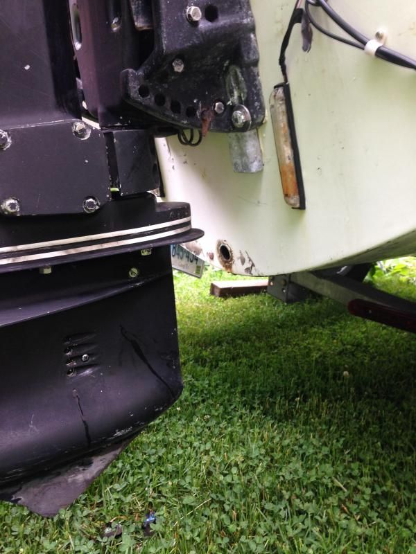

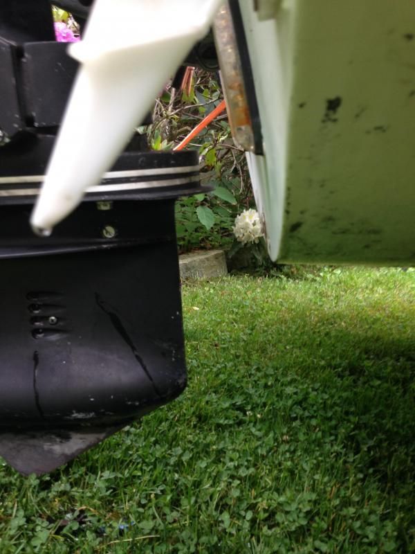

Totally forgot I had that manual. Thank you for the help. I got everything back together and the primer bulb actually gets as hard as it should be which is nice to see. I took it out for a test run in a small lake and want to double check some small things with you guys. The model is a J90TXCDC 1. What should be the appropriate WOT RPM. My tach was reading 5000 at wot. I know for a fact the throttle cables were adjusted to the carbs before the rebuild. 2. A couple of times on the test run it felt like the engine slipped from gear and would just rev with no movement. A couple of years ago the main shaft that connect the lower unit and motor snapped and was replaced. It maybe has 50 hours on it. No more than 100 that's for sure. Could it be slipping out. Or could the engine actually be too high causing a similar problem? Possible cavitating? If that's the right word. I will post a picture in the morning.

Okay that's makes sense I will do that. My prop size right now is 13 3/4 x 15 To replace the prop am I going up to a 17 pitch and different diameter? There are so many different options.

My prop size right now is 13 3/4 x 15 I did some research and understand to raise the rpms i need to drop 2" off the pitch. They also said if your boat is loaded with people or tubing which we usually do to go another 2" . So i think im going to go with the 14x11. Does this sound like a good place to start I found a couple online that are 13 spline and should work.

Not sure you want to drop all the way down to an 11 pitch. An 11 pitch would typically be found on a pontoon boat-not a planning hull. Is the tach on the right setting?

That's why I ask you guys first. I'm glad I didn't buy anything. So 13 possibly. My tach is at 6P right now.

So took it out today on the CT River. Ran great no real hiccups except when idling, If it idles a little higher than its set at it does fine though. I didn't pay too much attention going down river but going back up river it was only hitting 5000 rpm at WOT and only hit around 20 mph. Obviously the river has a part of that but on the way down i dont remember seeing going any faster than 25. Should I try to adjust the throttle cables and get the 13 pitch prop?

Agree: I'd probably do a visual inspection on the carbs when at wide open throttle. Make sure the carb main throat butterflys are completely open, or parallel to the length of the carb throat- first. You may be able to move the carb butterfly slightly by hand to make sure they are open. (they can be adjusted to over-rotate slightly so that they begin to close again.) Just be sure the engine has full wide open throttle capability. (You have to take the airbox cover off in order to see this) I'm still confused at the 15 pitch you are running. I rarely see a crossflow that can't run well with a 17 pitch. I could see a 15 pitch in a few instances. But a 13 is the direction you are headed and there may be something else going on. Have you done a compression test on the block? Maybe it's tired-low compression? The engine should pickup 300 rpm's if you go down to a 13.
