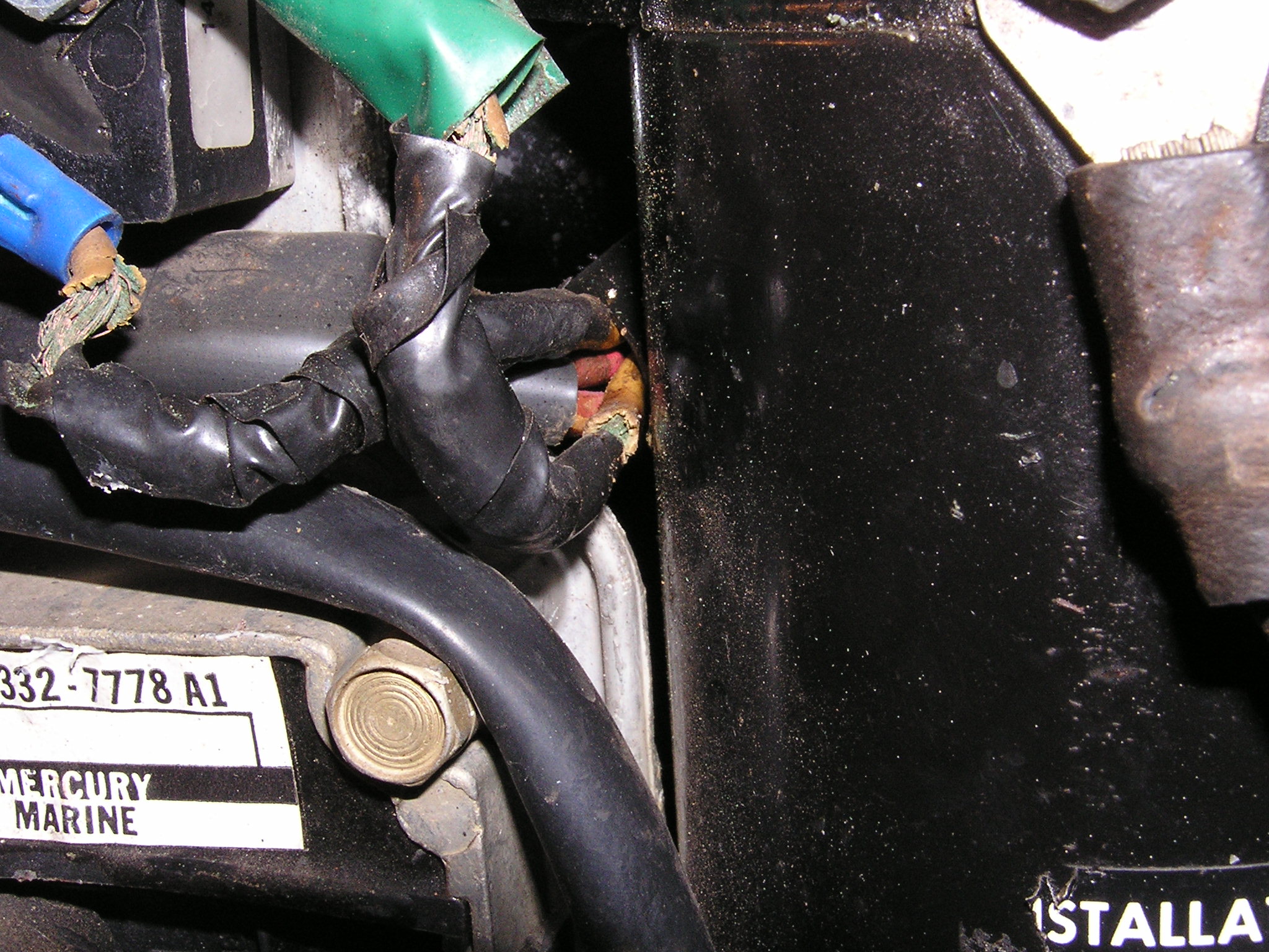

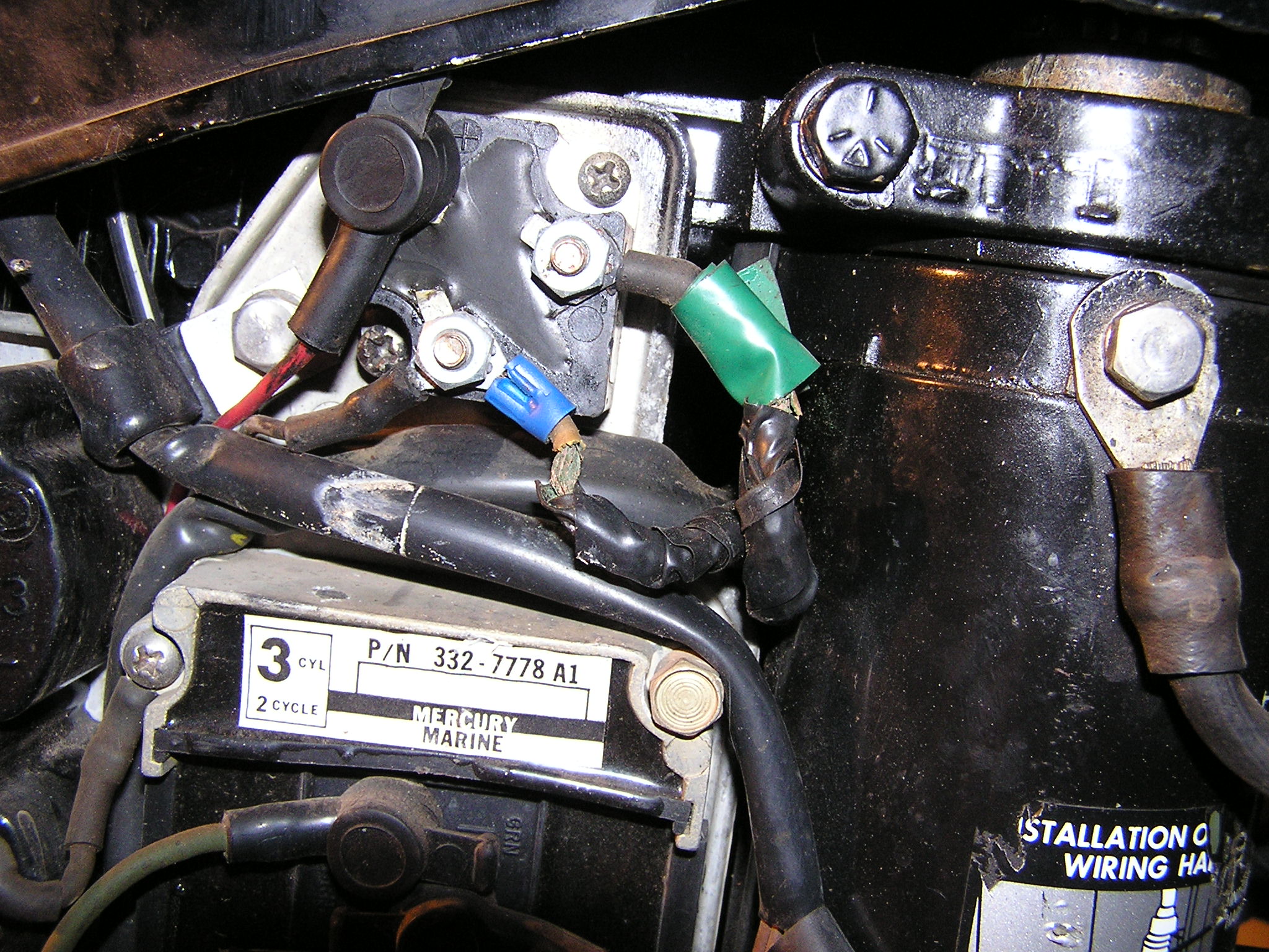

Ok great repository of knowledge. I cleaned out my carbs (again per a friends suggestion) and just got back from the lake and still I have the same problem. I decided to check out the motor as soon as I got home. Now, like I said the motor runs fine at an idle, but soon as I gave it throttle in gear it would drop its rpm's from 4500 to about 3000. By the way thanks for the info Clams Canino, I am a new/second time boat owner if that makes any sense. Anyway, I decide to inspect the wiring a bit closer and I believe I may have found the problem. If you can, check these pics out.<br /><br /> http://www.buchhorn.net\motor\P1010307.JPG <br /> http://www.buchhorn.net\motor\P1010308.JPG <br /> http://www.buchhorn.net\motor\P1010309.JPG <br /><br />I believe I have found my problem. If you look really close you can see tha tthe yellow wire was shorting to the starter. The one question I have you you gentlemen.. and ladies, is does any one know what these wires go to and what they are for? If I had the manual that came whit the boat I would find that out my self, but i just figure that some kind soul would tell me rather than refering me to the manual. Thanks in advance for all your info! This is a great forum!

Saltydawg<br /><br />Looks like the two yellow wires go from your rectifier to the stator. Charges the battery.<br /><br />Dave..

Ya.. yellow may or may not be the problem. But a good place to start and needs fixing anyway. Both of these motors have an existing history - so that we're SURE they aren't overpropped - right???<br /><br />-W

The motor has not been overpropped, but I will be getting the original prop back on here soon. It is off getting repaired. The original one is a 13" x19" orginal Aluminum prop and the replacement/spare I bought is one of those Comprop 12.7"x19", but I will go back to the Aluminum one once the shop is done with it (previous owner put a 2" crack in it). The wires are completely corroded and Hopefully today I will replace them and test out the motor tomorrow.
