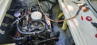

Alright... for the life of me i can't find the oil dipstick. I have the port side exhaust manifold off as all and I'm looking all over... what am i missing?

On some 260 models the dipstick is accessed from the front stbd area of the engine assy. Painted black so as to visually blend in nicely with surrounding areas.
Later/other models mcm/mie used a yellow colored pull end so as for quick identification

My boat is a 1987 with a Mercruiser 260hp. See the picture below - red arrow points to where my oil dipstick is. It is at the front of the engine, amidst the pulleys and coolant hoses.

Ayuh,.... Chevy moved the dipstick to the starboard side, in 1979,.......

Here is the only pic i have right now. Still have had no luck locating it. I'll take more pictures next time I'm out at the boat.
