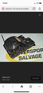

1987 Johnson/evinrude E110xcur. Wondering two things about this motor. From info I gathered it is supposed to have a belly pan. It does not. Curious about why it wouldn’t . I believe it was rebuilt and maybe is a modified motor now?

What do you mean by ---" belly pan "----here?----Or are you referring to the exhaust bubble ?

I thought this was to referred to as a belly pan

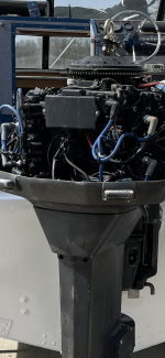

Hard to see but mine is flat.

That would be the outer exhaust housing.------Your power head may be a 90 HP version.----Or an older 115 HP ( powerhead rated ).-----It may involve a bit of machining if you are keen to install that.----Do those plug wires have a metal core?----And why are they so long ?
