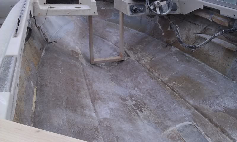

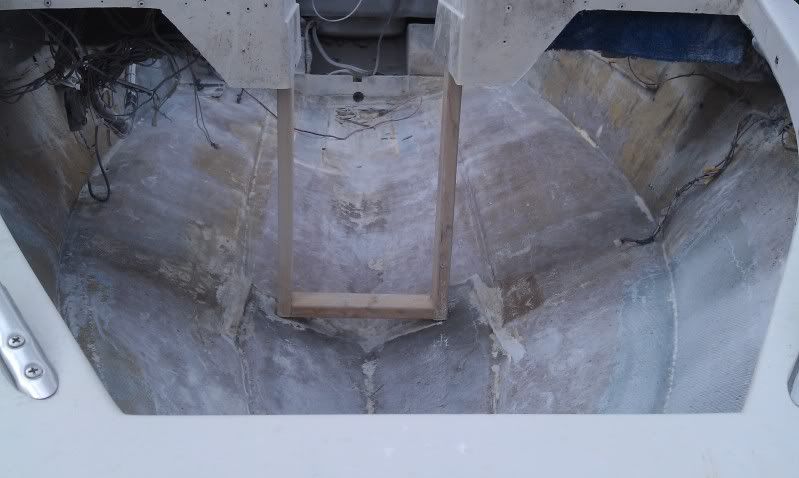

Here's some pictures from todays progress

Nice job! Looks like you've put in a ton of hours getting all the rot out. Now, that the grinding in done (definitely, the worst part to all this), you'll start to see it all come together.

I don't mind cutting it. I guess i was looking for a little guidance on glassing it back together, but i know its possible so I'll worry about that later.
That's actually not to bad. With patience and Sanding and filling and fairing you should be able to get it back to where it won't be noticable. You can always remove the entire cap if you so desire.
