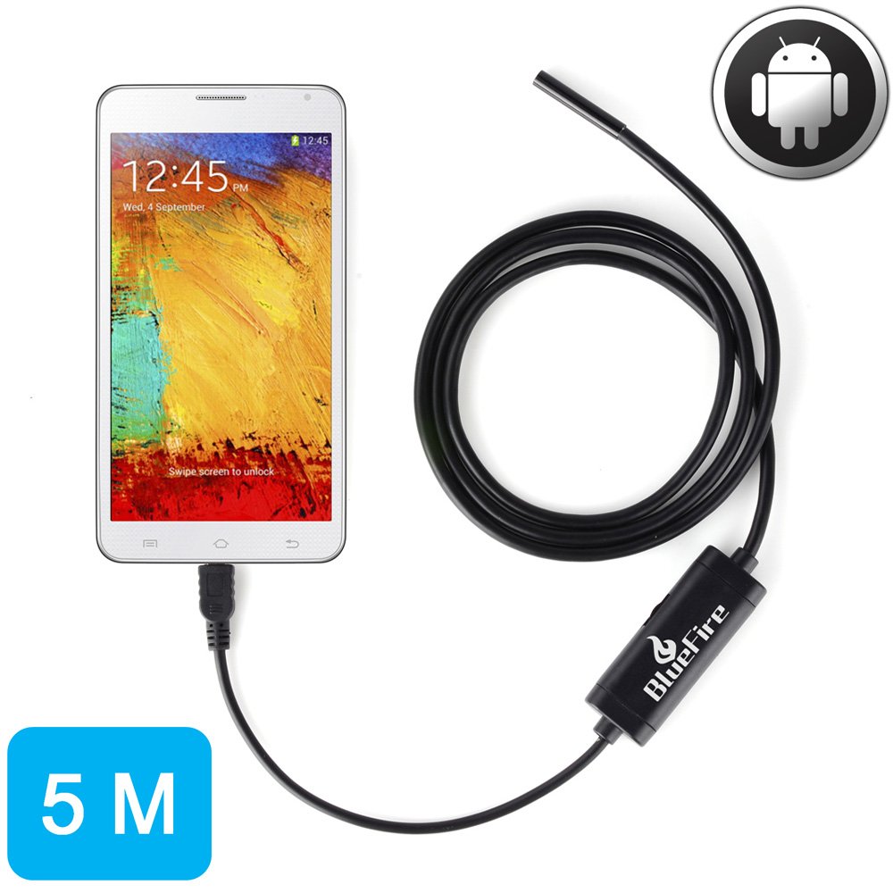

oh forgot to tell you guys i purchased that Endoscope for the cellphone and checked out my gas tank , that thing works great and inside of the tank looks brand new :) there was a couple brownsluge specs but i was fearing the thing would have been full of varnish but nope :) and no corrosion!!
https://www.amazon.com/BlueFire-Android-Endoscope-Phones-Function/dp/B013HZCYXK

That is a cool toy/tool. I just had the otg checker run on mine to see if it worked. It does. You always know where the cool toys are don't you?

since mine is buried deep in the sub cockle region of the boat, i wanted to be sure it was good shape or replaced, i would not bat a eye at replacing if it was suspect, but hell even the gas was good in it , i pressure washed boat with gas from it , lol i used a fuel checker first to be sure it was good :) my problem is , No one seems to make a 82 gallon tank that's 5 deep to 9 in middle deep.

Great tools. I have a couple different ones I use for checking my rifle bores. The one I attach to my tablet was great to check the reeds in the manifold when I had the carb off. Saved me from pulling the manifold.
