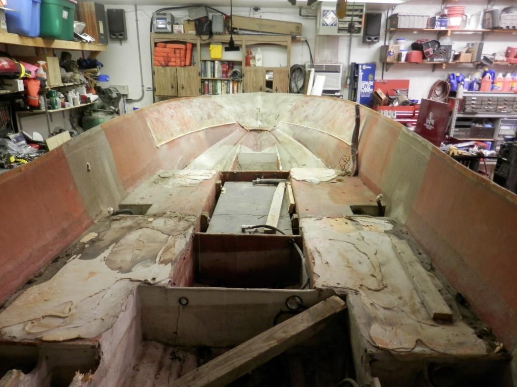

Well, put in one solid weekend on the project boat. Very difficult task to get a small piece of the cap off and the floor is still resisting. Once I got the cap off I started in on the floor and I am really struggling to get the liner floor to release from the boat. I suspended the boat slightly off of the trailer and used crow bars, shovels, and pry bars to try and get a small section up with no luck. I am thinking about buying a pneumatic air chisel to try and get the copious amounts of PB to breakup underneath the floor. Any advice would be appreciated. I also got my first look at the transom and it is basically 2 layers of 3/4" ply with a layer of CSM in between. Should not be too hard to remove since it is basically dust.
Boat suspended - no movement on the liner floor
Closeup of the liner to hull - copious amounts of PB. Think an air chisel between the floor and liner will work?
Transom Cap - this was an all day affair to cut this one littel section out.
Transom core is dust - at least it will be easy to get back to good glass.

Just completed one long day on the project boat, but finally got the deck out. Shakedownscott was right, it fought me for every inch until the very end. The wood under the deck was in great shape which made for the difficulty in separating the bond between the floor and the deck. The stringers closest to the fuel tanks are a different story...hollow shells of fiberglass. My best guess is that the rot started at the transom and worked its way back up the stringers. I pulled some pockets of foam out down to the hull and all of it is bone dry. I was going to leave the cap on the front, but since I have gone this far I am going to go ahead and pop the front section off. It will give me better access to do a complete and thorough job. I plan on doing a little more bracing tomorrow on the hull and will then pull the cap the rest of the way off and then continue the demo.
Using wedges under the deck to break the bond. This was no joke, it took a lot of effort.
...but it finally got done.
