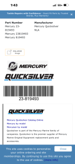

I just looked on Marine engine website and it 8s a E2 Mercury Quicksilver 23-819493 Bushing OEM New Factory Boat Parts. So it's factory.
Wtf.
