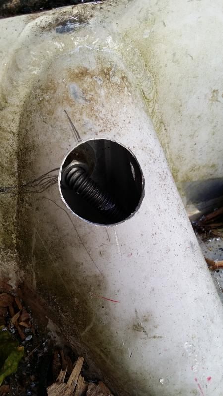

Well i cut access holes to expose the last two bolts in the transom. They obviously never intended for these to come out as they just hammered over the extra thread length in order to cover them. So i will definitely have to cut them out. Ugh... Hope this is the last of the surprises with the transom.... mark
If you could reach in with a small grinder or oscillating tool on the nut, cut 1/2 to 3/4 way thru then split it open with chisel/hammer. Or cut that bent pc. of bolt flush to nut and work the nut off.

Cutting will certainly work but you might try something like a beefy adjustable wrench and large screwdriver to bend it back and forth until it breaks off. Just a wild idea from a former maintenance machinist.

Yeah, I'd use a multi-tool or a dremel to cut that bent bolt off so I could get the nut off.
