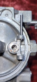

Carb: upside down, the float should be level, hook up a hose and try to blow through the needle/seat, should be no air going through.
Turn up: the drop should almost touch the post.

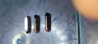

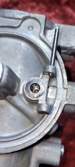

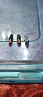

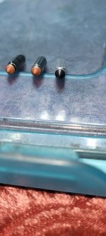

The seat has no rubber on it. I took pics of the needless. One seems to be more grooved than the other and the silver one is off the market. Any thoughts on the off the market ones? I have a seat for it.
I did adjust the floats as you mentioned.

No rubber on the seats, the rubber on the needle takes the place of the seat. The pics show 3 needles. One has a groove around it. I would change that.
The black tip looks like it needs replacing too?
Try to replace the whole thing if you can remove them without destroying it.
gica
Feb 24, 2016
582
The black tip one is new.
And it is an off the market cheap kit with seat and needle. The seat on the carb is in there good. Maybe heat and a reverse screw or something to take it off.

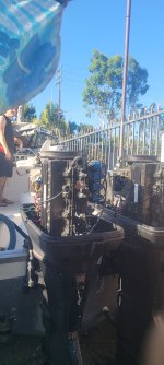

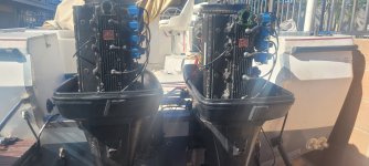

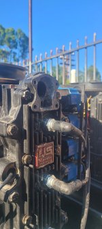

Hello again so I cleaned and adjusted the floats on the carbs. The gas does not get sprayed out when I squeeze the prime bulb.
The engines start I got idle, still have to adjust it all, the gear selector and the gas selector because they kind of interlock.
I saw somewhere that the lower unit shift bar has to be turned in all the way and turned out four turns. Mine is one turn.
So if I disconnect the gear cable I cannot turn the gas up to rev the engine.
The main problem is the water circulation on both engines is not there. BOTH get hot and the alarm goes off.
What the heck could it be?. I have a tank under one engine and muffs on the other. Same thing happens . I poured water from the top and it comes out the two exhaust nozzles from the middle of the engine. And at some point it comes out the middle area of the propeller. I don't understand if it was only one engine I would say something is wrong but both??? Is tyere a trick to this?
So I need some help here fellas. Thanks again.

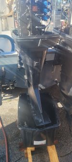

Ok I put it in gear revved the engine and water came up the tube. I have to put the
thermostat back in and see if it still heats up.
tg3690
May 7, 2019
1,116
Looking at your pic with the motor in the bucket.....water needs to be well above the cavitation plate (4-6 inches) for the pump to work right. That could be the problem with that one. The other one, maybe the muffs not sealing good?

Nordin
Jun 12, 2010
2,696
As topgun3690 says, the water level need to be above the water impeller housing.
The impeller is not self priming, it need to bee submerge.
Water level need to be at least 1 in above the top of the impeller housing, 4-5 in above the split line of the gear case.
Regarding running with muffs.
Are the muffs sealing right, can the garden hose supply with enough amount of water?
The impeller can pump really much amount of water.

Facts need to be understood.----Water must be 6 or 8" above the impeller in a test bucket.-----Testing in a small bucket is a common mistake that folks make every day !
