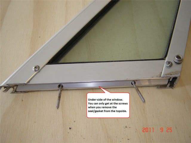

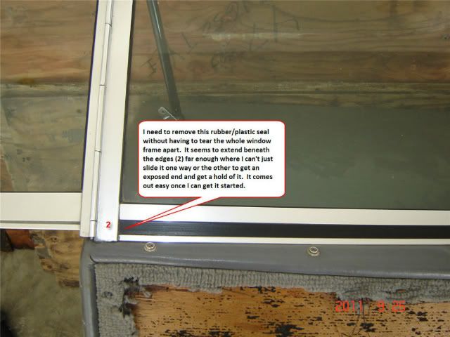

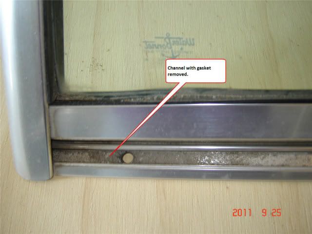

How do you remove the window seal without dismantling the whole window? I was able to get one removed but only after tearing the window off the console and dismantling the window frame. This won't work well come re-assembly time since I need to get at the frame screws to re-attach the window to the new console with the seal removed. I've tried sliding the seal left or right while in the frame but I can't get an exposed edge to lift. Do I need to try and wedge something really thin into the seam? It comes out pretty easy once started.

I used the Nautolex adhesive over epoxy resin without issue.
You SHOULD be able to pop that window channel insert out with a screwdriver.
