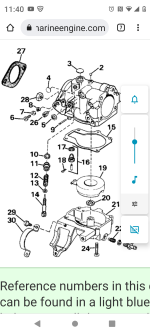

Any pictures of the carb when you worked on it.
