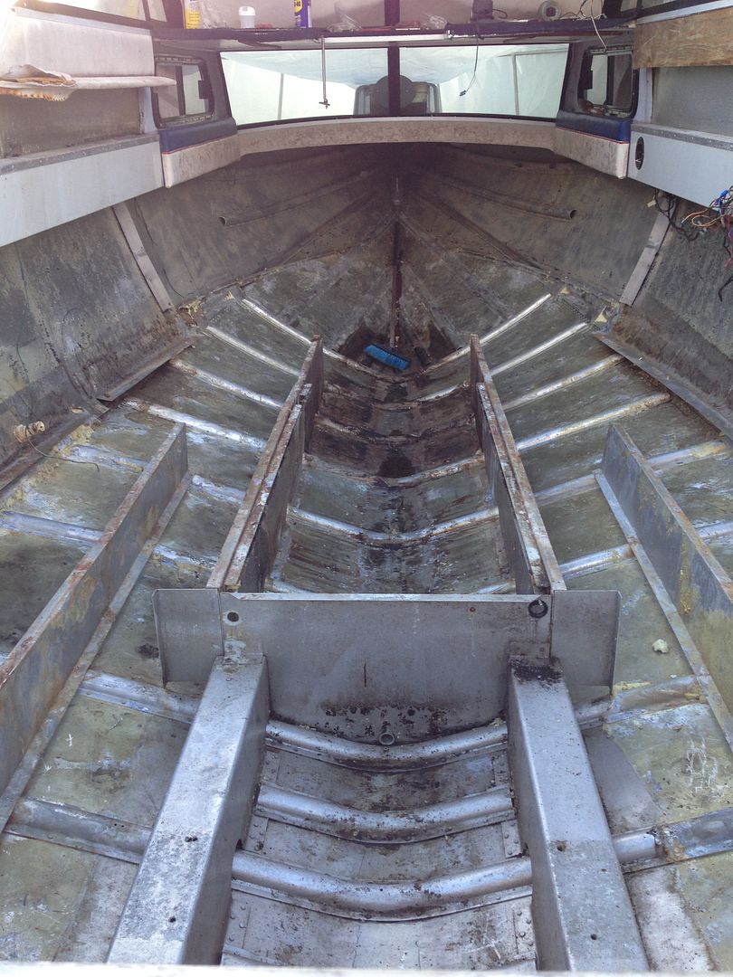

The Z bracket/channel is located normally at the bottom of the transom, the transom bottom rests on it.

Waterman - I see. Interesting. There are no limbers (not sure of the term at the lowest point of ribs that allows the water to drain. I see yours has them.

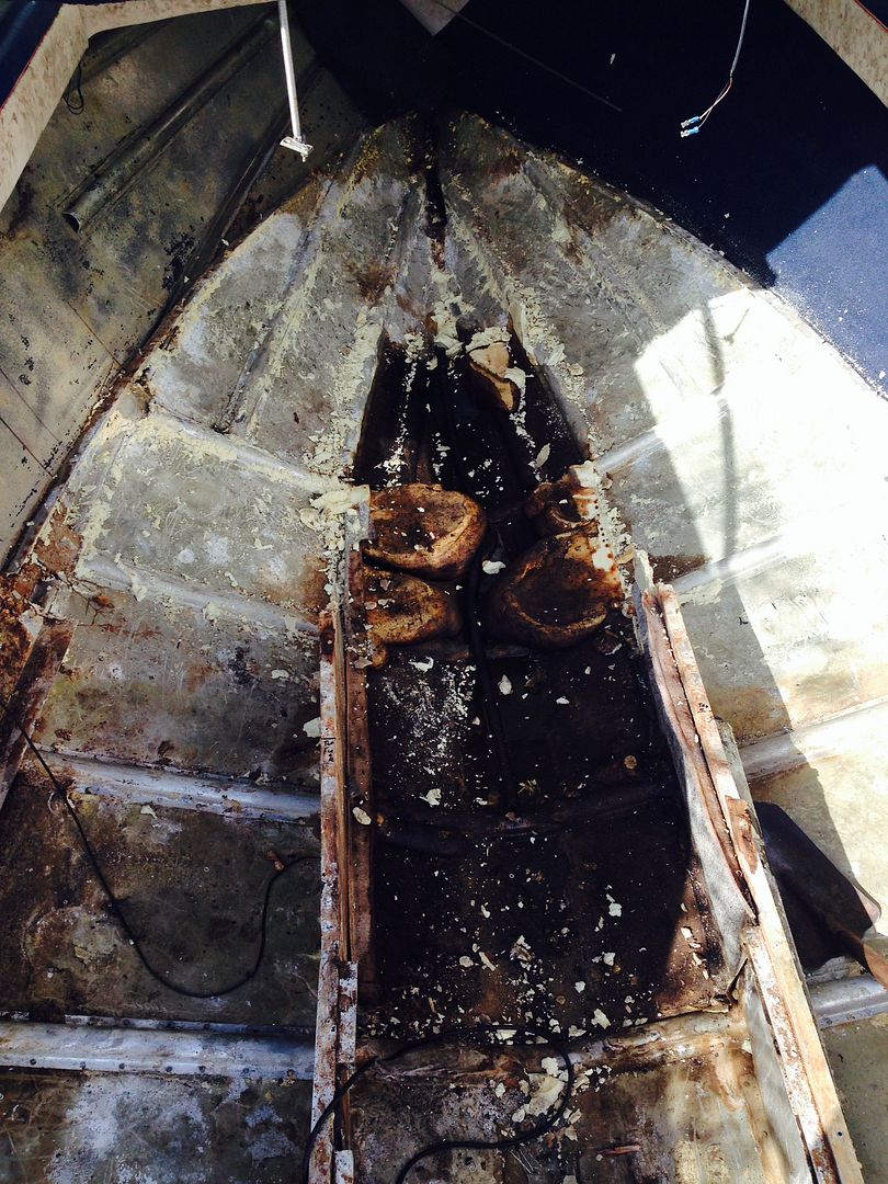

Hand-to-hand combat small garden shovel and the wet foam. I have numerous cuts. Spent 6 hours on my knees.

Removed the tank 38 gal tank yesterday. It had 20 gallons. Put it I'm my van. Found a hole at the top, leveled with the hose, right by the edge. See if you can find it. Tank was encased in foam and crooked on top of it. Did anybody even wonder why we never hear from former Starcraft employees or engineers? I was on a Chris Craft site and former employees would pop in, proud reminiscing, commenting etc. Where's the pride of Starcraft employees/engineers?

Found two holes in the hull right under the foam right under the tank. Will have them welded shut when I bring boat to my welder to have the outdrive and bolt holes closed off. I bought a gallon of Gluvit for the rivets and plating as well.

I got the boat back. The transom warped a lot more than I had expected.
pckeen
Jun 20, 2012
2,067
I would think that will straighten out when you put in the wood transom and bolt it all back up.
