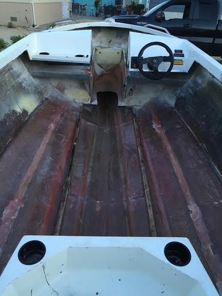

Worked my butt off this weekend! Sanding is all finished, pretty much the worst job ever. Being 6'4" my arms were pretty much exposed the whole time so you can imagine the itching. I sanded all the bubble in the glass on the stringers out exposing some wood, its in perfect shape. Im going to put fresh glass over them before I put the new floor down. I cut through the hull.... twice I am picking up some biax to fix those spots.
New steering cable and pivot tube on its way
Took out the starter, has anyone seen a good video showing how to clean them? The bendix sticks occasionally. I bought some 1x pine to build new bulkheads since thats what the stringers are made of.
The seat boxes will be a bit of a challenge since they sit on the floor and the hull. The have to be cut to match the slope of the hull, seems like this could be difficult.
I have decided to glue in carpet again so I dont have to worry about the appearance of the glass.

I have installed the new bulk heads and floor. I have a few questions maybe someone can help me out:
The CSM on the floor is not very smooth, will this be a problem when I install the carpet? Should I sand it smooth? I dont want to compromise it.
Is there any paint I should use to seal the floor and existing bow boxes? I will be installing carpet so I am concerned if I paint and then install carpet the carpet will only adhere to the paint and not the floor eventually separating.
Any chance of finding the factory Bayliner carpet since i left some it would look better if I find the same one.
As always thanks.
Woodonglass
Dec 29, 2009
25,929
The CSM on the floor is not very smooth, will this be a problem when I install the carpet? Should I sand it smooth? I dont want to compromise it. I'd sand down any MAJOR rough spots and if you do sand through to the wood just patch em in with some scraps of CSM.
Is there any paint I should use to seal the floor and existing bow boxes? I will be installing carpet so I am concerned if I paint and then install carpet the carpet will only adhere to the paint and not the floor eventually separating. NO PAINT!!! Did you use wax in the resin? If not you might consider putting down on more layer of CSM (I always recommend 2 layers of CSM on the topside of the deck unless you're gelcoating) and adding wax to the last batch of resin. It'll help with waterproofing the deck and make it easier to sand. It'll help with the smoothness too.
Any chance of finding the factory Bayliner carpet since i left some it would look better if I find the same one. I doubt you'll find the factory carpet for this age of boat.
