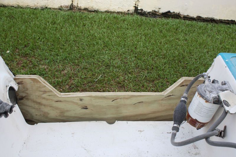

I have seen TiteBond @ HD and douglas fir too, regarding the floor replacement I used Dry Treated Plywood, the one in the pics here. The stringers still solid as a rock but have to mention that they are fiberglass overfoam.

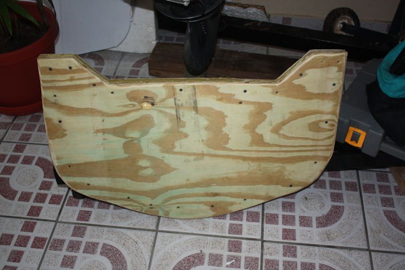

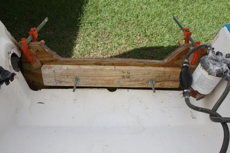

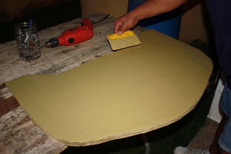

Ok, finally cut the transom out from Treated wood and "sandwich" it together with Liquid Nails Polyurethane, this products works nice and dry in just 8 to 12 hrs, NOT 72 as some one said around, well maybe because of weather or temp in other states. Take a look!
both panels already glued together, its looks as one piece, btw very strong wood can hold up to a 200 HP Outboard with no issues.
Here is my new friend with some gypsom board screws around
Splashwell view...
Another one
Inside view of the real thing, have to grind a little to almost a perfect fit, Im happy with it.
Next Step, first glass.... More pics coming soon, stay tuned!

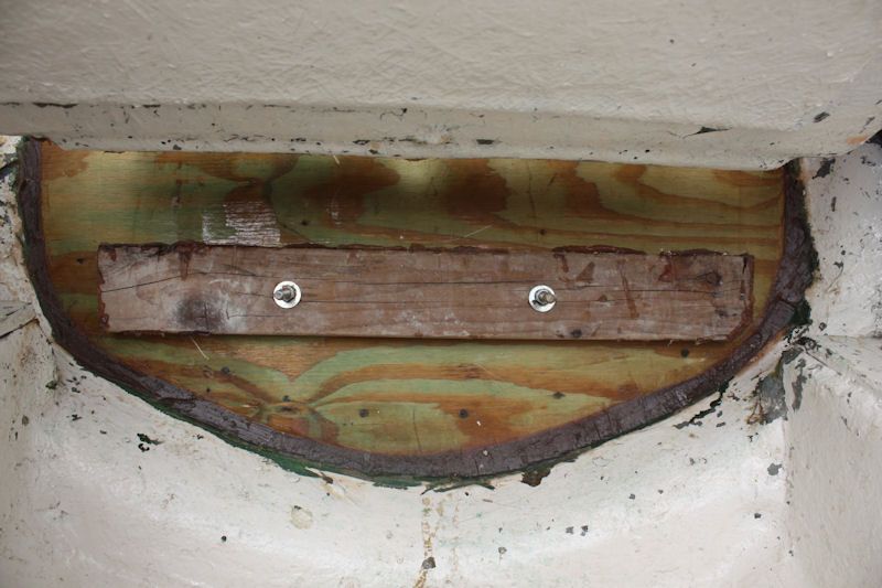

Alright, Transom already IN!!!! YES! Fit very well no problem, lets start Step 4...
PB working, still need a little more, NEXT, FB!!

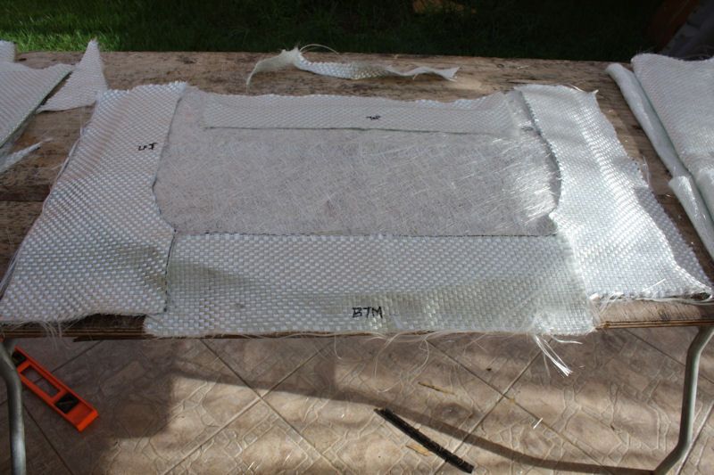

Cutting fb patterns for glassing, first pic shown the combination mat Im using for tabbing the transon.
Patterns over transom template, 3 inches outside 3 inches inside
It should looks like this when tabbing done, the csm goes in before start tabbing.

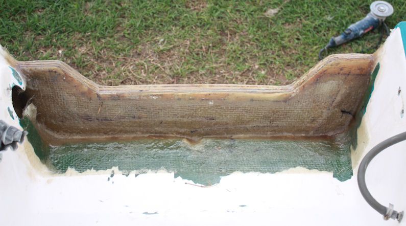

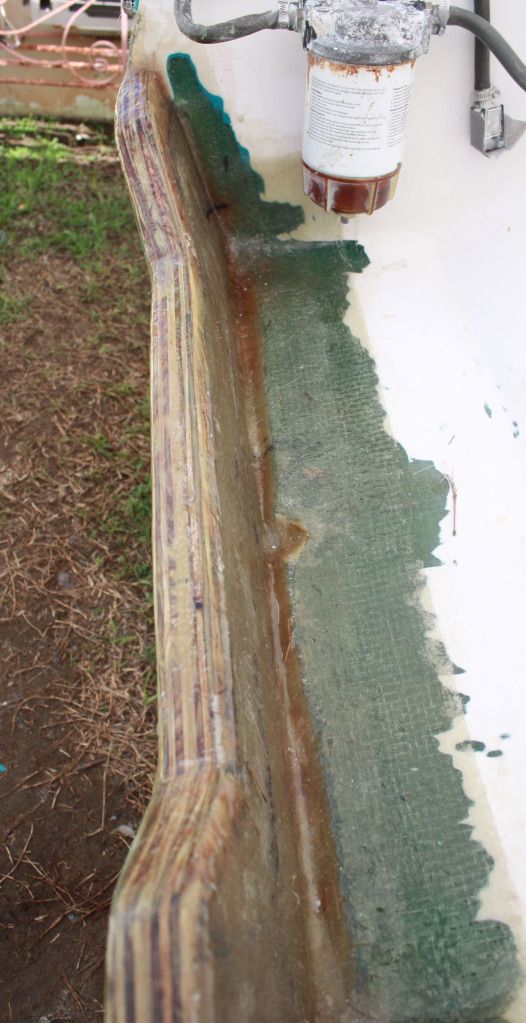

Just a few hours working on transom today but keep moving this resto, here is a view of back of transom upper area, 2x4 woods already moved, the pattern and outside transom tabbed toghether hrd and strong, no doubt, grind a lot and Im thinking need a little bit more, start to get ready for one coat of FB to move then to gelcoat,ONCE repair the splahswell.
Inside view for tabbing, as you can see I do not have enough room to move in but the tabbing looks and feel strong, one more (maybe 2) glassing of the Combi Mat here to end this process, "i hope"

Did you put glass on the wood before you installed it? Did you coat it with resin before you applied the glass? I'd recommend your tabbing to extend 8-10 inches out on the sides and bottom. PL does not totally stop outgassing for 72 hours and does not reach it's final cure for up to 7 days. It may appear to be dry but it is not. If you research the technical specs you will find this to be true.

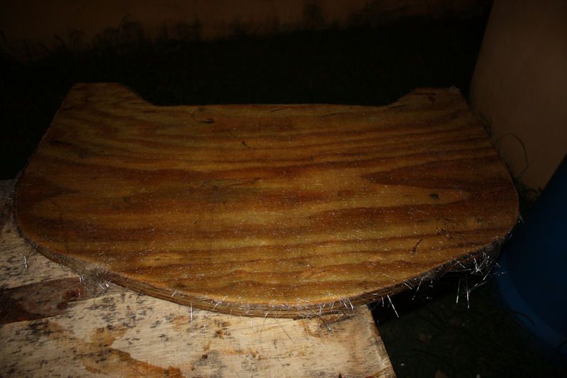

I put glass at the back of the wood before install it, wood was coated with resin before glass application. Up to date 6 days has been passed already, so for final cure, it will be there as soon as tomorrow! Anyway it was set in 12 hrs, I leave it overnight for PL kick.
Here is the pic for 1st glass

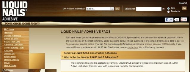

Here is the technical specs, its dry from 8 to 12 hours, as I said before could take longer because of weather, temp or humidity. This isnt the case here since we have a daily temp of 85 to 90 degrees

that spec is a bit misleading....says cures in <12 hours....but if you look at the sheer strength spec, is says after 48 hours reaches > 250 psi....if it was fully cured after 12 hours, sheer strength would not increase beyond 12 hours....
the chemical composition reaches a cured state within 12 hours, based upon a minimum sheer strength....but continues to outgas for up to 48 hours, which increases it's sheer strength....it will continue to outgas even longer, but no significant increase in sheer strength.....
but during all this outgassing......that vapor needs a place to go

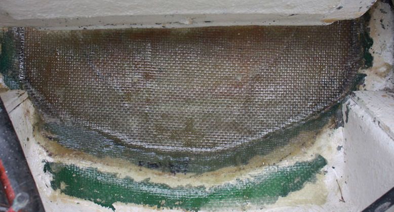

Ok, big improvements, transom glassing complete, splashwell almost complete looking forward for sanding final touches
Transom inside view, have tabbing, one glass of CSM and 2 CombiMAT,
Topview of my friend here with the splashwell open

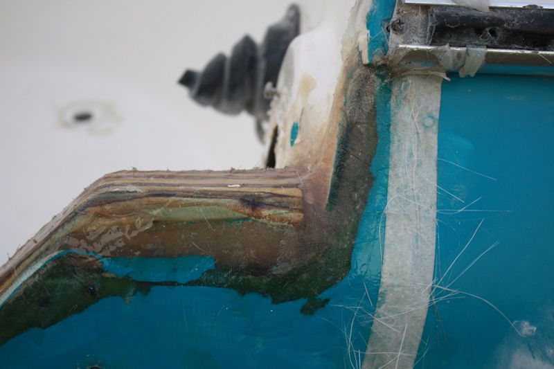

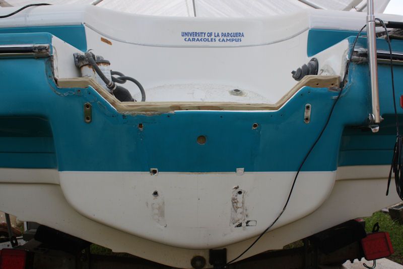

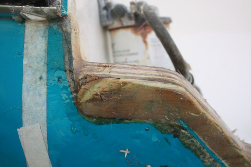

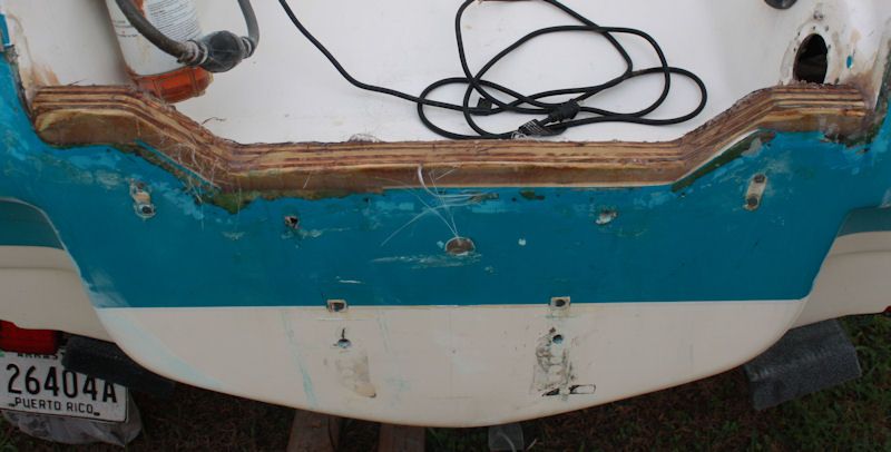

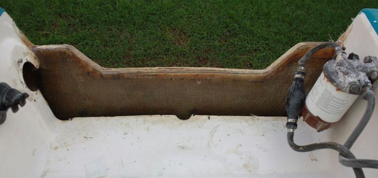

Port side , this one was broke cause a weak transom, starboard side already open too but now has been fixed, just compare with post # 1 pictures 3 and 4..
Splashwell already fixed, just left here a little detail at the left of the pic, have a piece of wood for this, then will complete the glass here, also need to open the water drain at the middle of it. Need to reduce in the middle of the transom no more than 1 inch, thast why the glass doesnt go up to the top. Nothing serious but now have to round over the top.
Side view...
Take in consideration that this pictures has not been edited in any way, this is the real thing, when times comes make up will come to a nice and neat finish....

is the edge of the new glass laying on top off old gelcoat or paint (the white surface)? in the picture above
