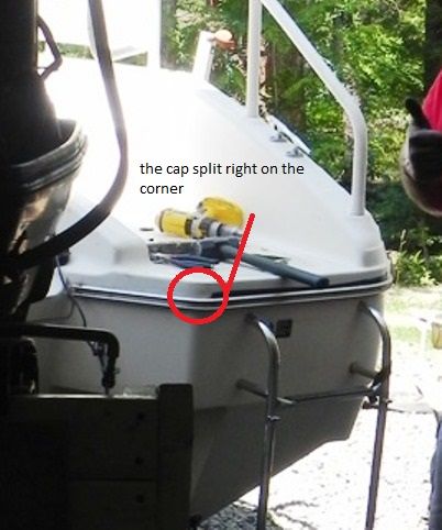

Ok weather getting a little better now, so getting back at it. I had gotten the cap back on before winter hit...sorta. strangest thing the one area I would expect it to fit back together easily it would not. see pic. trying to force it on I cracked the glass, which probably isnt so bad since it wouldn't fit. Question is best way to fix this area. I am planning on getting it set where it should be, and laying a couple layers of 1708 on it. I have sprayed the hull beneath the area with mold release so hope the resin wont stick to that area. Sound like a plan? I'll post a pic of the ground/sanded down area later tonight.http://i1278.photobucket.com/albums/y504/audijunky_13/DSCN1741_zpsc73b6366.jpg

Actually, getting the cap to fit back over the transom area is usually the most problematic. I'd prop up the cap with a 2x6 and then I'd grind down the top edge of the transom until the cap fit quite easily, then recoat the edge with resin and a layer or two of CSM. Let it cure and then re-fit the cap.

Thanks for responding Wood. The actual area where it wasn't fitting was a corner behind the transom. And I cracked the cap in that area trying to force it so I kinda fo did what you said but to the cap and not the hull/transom. What I did do was grind down the busted glass, fitted the cap, coated the hull with mold release, tapped it off as well, and the put on a layer of mat, followed by 2 layers of 1708, and one final layer of mat. (kind of made the cap a little wider in the corner it was tight). sanded, filled with resin filler, sanded and gel coated. Doesnt look brand new but its solid. As of now I am waiting for a day off and decent weather to fit the outboard back on...Getting excited
