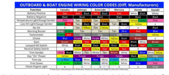

Find a wiring diagram online.----mastertech marine.-----Early 1990's V-4.----Wiring is the same / nearly the same as your 50 HP.
