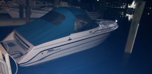

Well, it is once again time to update this post. The end of last season went smoothly as the wife and I enjoyed the fruits of our labor for the until mid-November, when it was time to winterize the boat. We made lots of long day trips on the Chesapeake and one overnight to a town named Cambridge, about 45 miles away from our home port.
During the 2020 season, one issue we had was the smart tab retractor plates kept breaking due to their flimsy design. Nauticus sent us multiple sets, but they kept breaking so we decided to go with helm tabs for 2021.
I added chrome vents with drainage boxes to keep water out of the bilge.
I added all new stainless cup holders throughout the boat...a huge upgrade over the black plastic ones.
Upgraded helm with chartplotter, new vhf, and remote control:
I also took the original cockpit cover--which had a few small holes and tears--to a canvas shop to be repaired and reinforced and the result was excellent:
Our overnight trip to Cambridge, MD where the full canvas came in handy.
All upholstery, snap in carpet, and canvas are original OEM on this 26 year old boat!
Nasty Chesapeake water makes me miss my home state of Florida!
Cambridge is beautiful though:
Leaving Cambridge to head back to Edgewater.
Thomas Point Shoal on our last day out in November. It was 40 degrees F this day.
Winterization and a clean bilge for a few months winter's nap!
