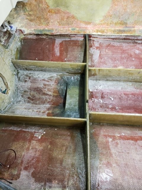

Big step tonight, everything for the structure is fully water proof now. Got the motor mount fully tabbed in 1708 and the rest of that bulkhead fully wrapped in CSM.
Also got the first coat of gelcoat on the ski locker, the picture looks real good but its pretty thin. I am planning on 3 layers with the last having surface wax in it, will see how it looks tomorrow after the second coat. Had to custom blend the color with purewhite and halyard from USC, I think it came out pretty close. Could be a little more white.

Thanks, ill have to check yours out. I will say unless you thicken it I don't think one coat will be enough. Just got done with the second coat and its still a little light it spots. Might depend on application method. I would think spraying would lead to better results. I will say in my pictures it look great but up close it you see its light.

Cut and put in some of the cleats before laying down the second coat in the ski locker. PL and stainless steel screws to hold the cleats on. Second coat looks better still lighter than I would prefer. The next coat will have surface wax so I hope its enough.
Question do most people put cleats on the transom? I really don't want to put any more holes into the transom but theres not much support back there either until I foam it.

Attached to the transom running parallel with it to the sides. You can see I have one running along the motor area and then one parallel at the first bulk head. Do most people put the same parallel one on the actual transom to support that back edge.

I may be wrong but won’t your PB and tabbing support your deck back there? I would think yes it should. But maybe I’m wrong.

We did not put any cleats on the transom. We glued the deck, PB the gap between deck and transom and then tab the deck. We avoid putting too much load on the edge before foaming it. It seems rock solid now.
By the way none of our cleats were installed using screws. the idea is to avoid drilling holes in the protective layer of glass.
It seems solid as well. We used poly based glue.

Ahhh, I understand now!!! Cleats on transom NOT necessary. If you think about it there's very little weight back there sooooo the tabbings are just fine. Just like there are no cleats required on the sides of the hull.

Obviously less holes would be better but I pre-drilled all holes and made a full loop of PL around each hole as well as coated all screws in PL before installing. I them smeared the excess PL over the screw hole as well.

hey Mike, you were right altough the gelcoat looks quite thick , one coat seems a little light. the coverage is ok buth you can still see the brown from the underneath wood. a second coat would be needed. not sure how to do it with the first coat being waxed... sanding before second coat?
we used a paint roller to apply it. (hairy type not foam type)

I was going to ask this question as well in case I need to do it. My guess would be to sand and wipe with acetone. People do repairs on the outside of a haul by standing and seems to get good adhesion.
I just finished my third coat and added wax to this one and I'm happy with the turn out.
