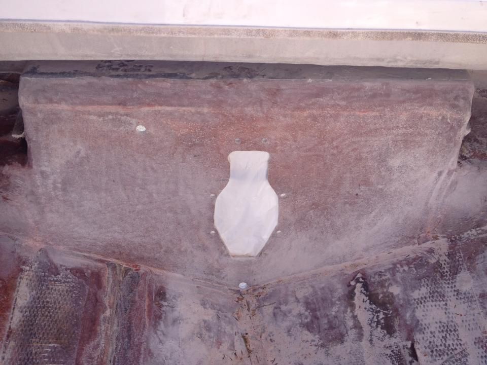

Re: 1995 Monterey 225 SCR restore

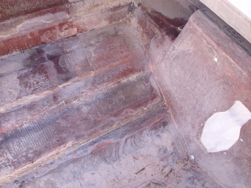

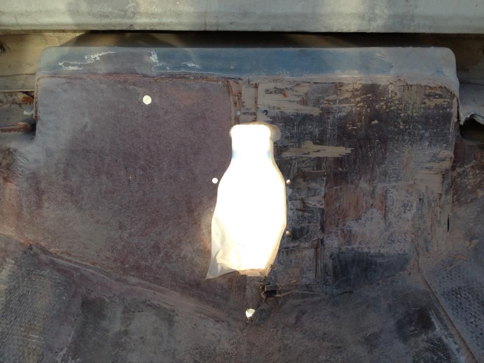

half way done after 2 hours with a chisel and pry bar.....and finally a 40 grit flap disc on a 4 1/2 in angle grinder.

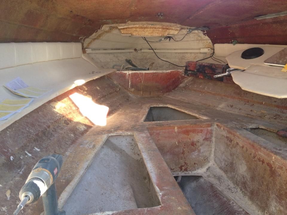

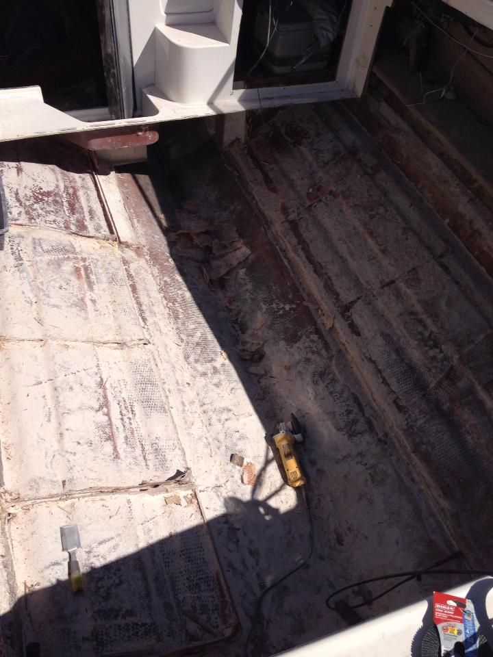

For some reason there is a 1/2 inch X 8 inch piece of wood running lengthwise that is glassed over, maybe this served as a stringer since there were no real stringers in the boat....just a bunch of bulkheads....debating on removing this and putting real stringers in.

grinding SUCKS!!! and the flap discs i use go fast

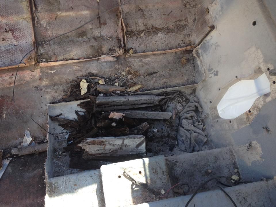

Gel coat the cabin or put carpet back in? Thoughts anyone?
How did the foam underneath the fuel tank look? Is the bottom of your fuel tank ok? The reason I ask, my 1989 Monterey 1900 had a soft spot. When the deck was torn out, we smelled fuel. The foam was wet and apparently ate a bunch of tiny holes in the 40 gallon fuel tank. It cost me $500 for a custom made fuel tank. Just curious...
I agree. I noticed your using 40 grit flap disc. It will go much faster with 24 grit. I found a great source for good quality disc cheap and shipped fast! Lehigh Valley Abrasives - Premium abrasives and tools at value prices
4-1/2 Zirconia flap wheels $1.89
4-1/2 Resin fiber disc aluminum oxide $.50
4-1/2 Resin fiber disc Zirconia $.57
There was no foam under the tank or fuel smell when i removed everything. The tank looks fine visually and thanks for the heads up... i will pressure check the tank to be sure. most of the foam that was in the boat was water-logged as well as the wood tho

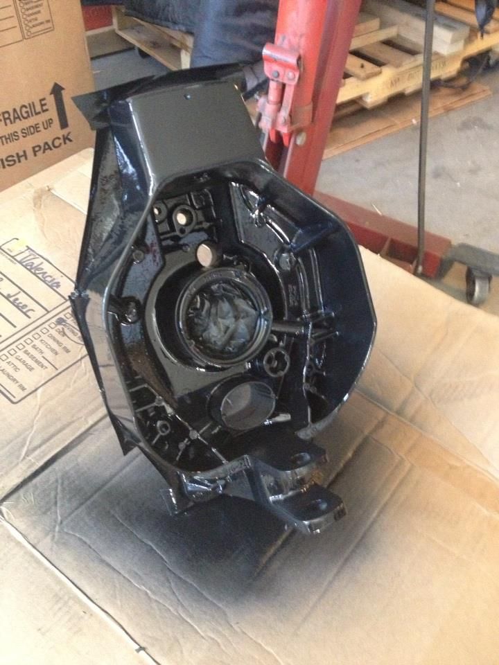

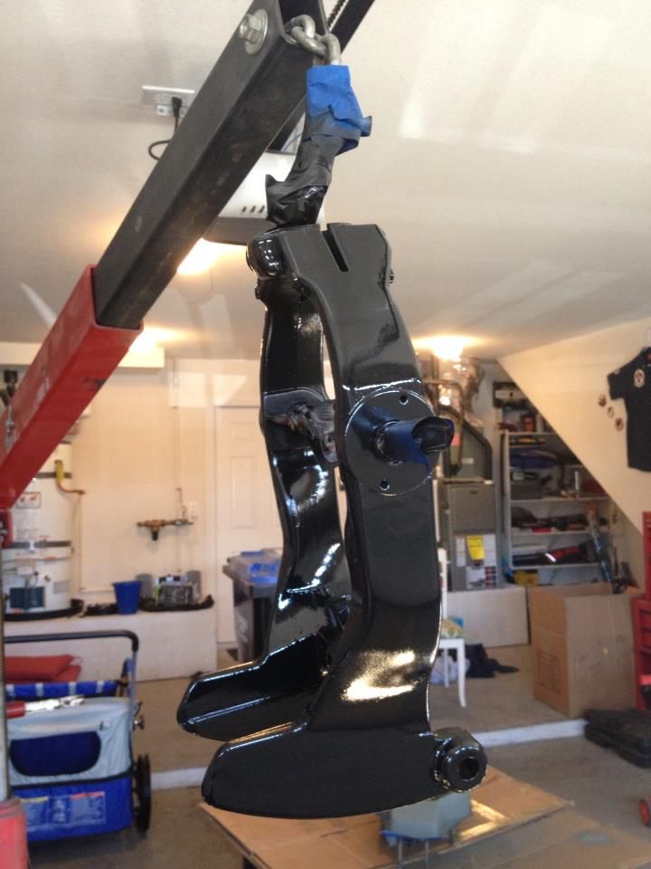

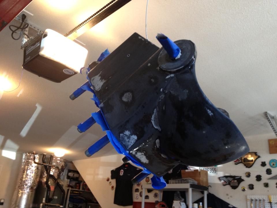

Primer came out really nice on the trim actuator

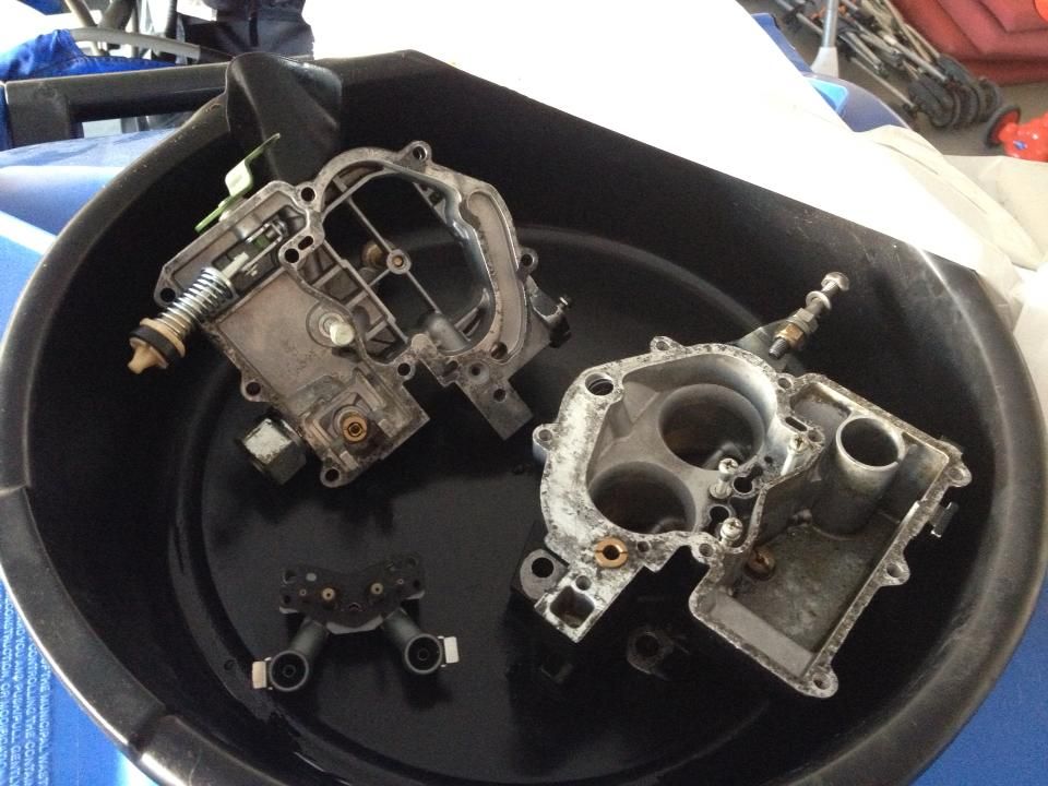

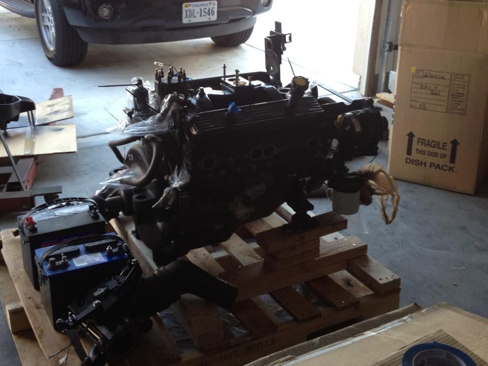

The culprit of my idle issues... or should i say the bad fuel that was in the tank.

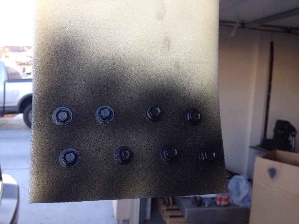

Re-paint of the valve cover screws... look like new
