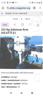

Just an example of my ability to get a used motor. It's about 1 mile from my house.
Even if it's dead the parts alone are worth grabbing it. (Port side temp sensor)!
Great northwest has lots of used motors so might be somewhat unfair.
