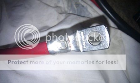

So I bit the bullet, ripped out all the main power and earth leads and went and seen a good mate and fellow fisho who manages an Autoparts store. Left it all with him, and with not much change from $100 came back with it all brand new. He was quiet, so he even crimped all the new eyelets on for me:

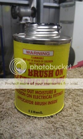

A quick mask up of the terminals contact area, then dipped the ends of all my new cables into this stuff (also got from a local Autoparts store, Im sure there is an equivalent in USA):

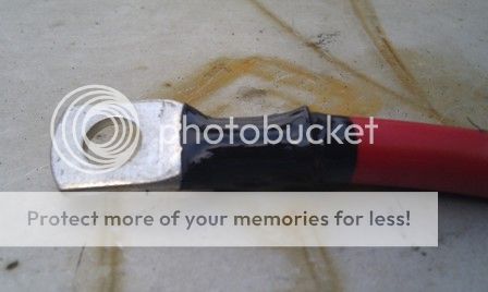

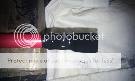

Came out looking like this:
Upon un masking (left to dry over night):

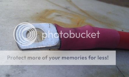

And just to make sure, some quality shrink heat shrink over the top:
