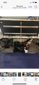

1998 Crownline 202br engine compartment access
Lou C
Nov 10, 2002
14,030
I bought 2 37” Wise pontoon boat seats that fit in front of the hinged bulkhead. I notched the wood under the coaming panel & it’s a perfect fit.

You need to post up pix. I showed how I did mine. It took a bit of thought but not hard. The final touches will be a remote oil filter mount & closed cooling. I am NOT pulling my rear seats every year just to change oil & winterize!
Your other option it take it to a good ’glass shop that does custom work and ask them how’d they do it. I could see cutting stuff to make it removable & use Dzus fasteners like airplanes to hold it together. My brother has a boat like that (2020 Chapparal with Merc 4.5). To change the starter or anything in the rear of the engine compartment the motor has to come out. Even if Merc’s fancy one point drain clogs & has to be rodded out, a tough job.
