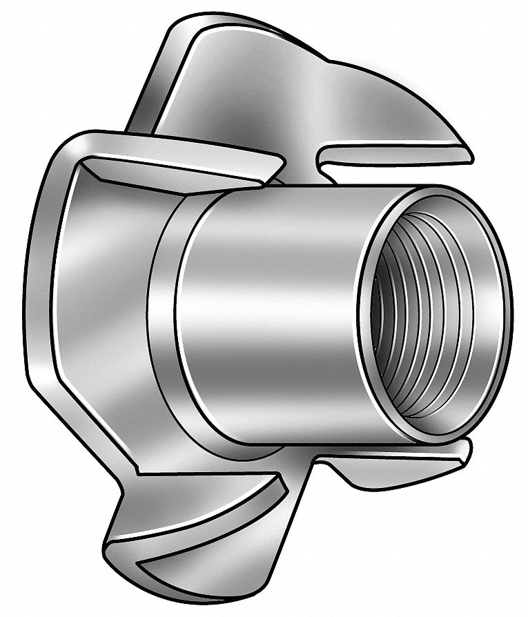

43,949
Is there any room behind where you could have a ridged back made and fasten it by using T-nuts?
