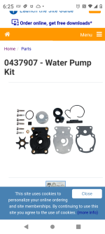

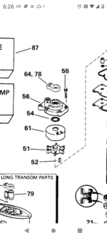

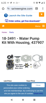

Parts breakdown for your motor looks just like the one your using. OEM #0437907 I included a Sierra pic too
Not sure what's going on.
I will try to find out what the previous # was we tried that looked like this. We tried several, by looking up part. Not sure why I got conflicting #'s but I did. The one we tried that had the same design seal as shown in the pic you provided, was too big. It was like for a 50 or bigger. The seal resembles what I believe would be correct. There seems to be a seal needed that would fit that way and lay flat and even across the surface of the midsection. I will try to get some #'s from previous and current housings..
