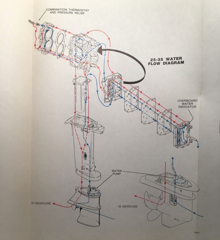

Nevermind physics, the cooling system on these requires the water to follow a PATH around the engine: intake screen > pump > motor base/adapter > exhaust chest > around the cylinders (where the deflectors are - that's what they're for...) > into the head through one hole in the head gasket > around and out of the head and head cover through another hole in the head gasket (either after the thermostsat/poppet or other port depending on temperature/RPMs) > then out the bottom and back into the lake. If you don't have the deflectors/diverters in place, the water short circuits and you have problems, typically it bypasses the top cylinder.

OK thanks that is very useful information I appreciate it. That makes a lot of sense because my top cylinder was the hottest and the bottom not so bad. I will clean the water tube out and replace the diverters then try again. Can I remove the water tube from the lower unit or do I have to tear into the top to get it free?
