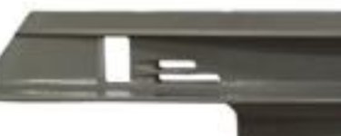

Yes I've actually been in contact with them and they couldn't tell me if it was theirs unless I checked the serial number on the inside of the lower unit. After more research I'm thinking more and more it is an aftermarket SE 304. I'm just a little confused because their website states "
SE304 Gear Case replaces most early style Johnson/Evinrude V-4 Lower Units
from 1978-1998 with a 4-1/8 bullet diameter. The case has internal Water Screens"
zooming in on the attached pics it looks like an exact match.

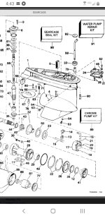

Could this be it?
Gearcase Parts for 1994 Johnson 90 hp J90MLERC Outboard Motor​
attached diagram
Its pouring out or i wouldve checked the prop😟
39,503
Many years of crossflow V-4 have that gear case!!----And gearcases from say a 1980 model V-4 would also fit.----So easy in my opinion.
