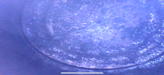

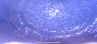

I haven’t removed valve cover but I did boroscope the cylinders. They look ok to me, there appears to be a significant amount of carbon on pistons and some on valves, but I’m unable to see if they hit the pistons, i can see the valves moving but not sure if they’re sealing. Here’s screenshots from my phone:

99yam40
Sep 7, 2008
9,250
good news so far.
did cylinder walls look OK
now pull the valve covers and check valve clearances, maybe too tight .
or if bent too loose., I cannot think of much that would cause all cylinders to have low compression.
if valves are good, all rings stuck maybe
that one 5375 pic bottom right looks like something wrong on edge of piston/cylinder
runninfarmer
Jun 28, 2012
140
My boroscope is cheap, lol, so not the best, but the cylinders looked smooth. I didn't see any aluminum transfer. I was initially concerned about that piston as well, but I believe it's just the fogging oil I used pooling there. I think the camera is tilted in that orientation.
