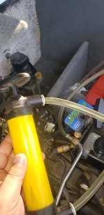

ok i primed it by connecting a hand pump to the fuel line and sucked the gas out and now when i crank i get a pulse of gas every second or so.

ok, now let that fuel sit for a day and see if it separate's and had water in it.
