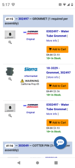

11 & 12 If I pull down water tube to check grommet will grommet come down with tube? How hard is it to replace grommet?

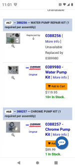

Rebuild the water pump with an OEM kit and replace everything.
Increase your idle speed to 725 rpm.

Impeller almost new, inlets clear .I'm attempting to take apart and reinstall pump making sure water tubes are inserted properly in grommets.
