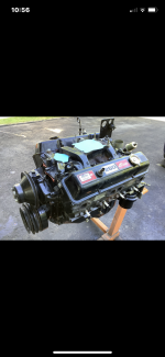

Just another quick question for anyone who knows.. will a Mercruiser 350 bolt up in place of my 4.3? Both late 80’s Motors but the 350 is rebuilt with receipts and looks real clean for a decent deal.
It will bolt to the flywheel housing
Was the motor built as a marine motor?
You will most likely need to fiberglass in new mounts
Do you have 4.25" extra in the bilge
You will need new exhaust manifolds, a new marine distributor

Yes it was a marine engine that got rebuilt. It includes new exhaust manifolds/risers , wiring harness and thermostat housing.
I definitely have the extra bilge space as I move the fuel tank forward about 8” when redoing my stringers and floor.
Thanks for the answer!

Be some work and significant added expense. If you like doing fiberglass fab work the extension on the motor mounts is easy enough. Will be interesting prop'ing the 1.84 4.3L drive to a 5.7L motor.

Thanks for the reply Rick, What added expenses do you figure? I know I’ll need a new distributor as Scott said, it includes the exhaust manifolds/risers. Anything else I’m missing that won’t be reusable off my 4.3?

FYI, if indeed a thunderbolt ignition the distributor will be okay. You need a v-8 cap and rotor and as I mentioned earlier a v-8 module

I asked him if it included a module and this was his response…
It had a Mallory points and condenser distributor that I swapped the points out for a Pertronix Electronics ignition kit in. Way more reliable than any Thunderbolt module and if it were ever to fail I can put the points back in and be boating in 10 minutes. I’ll throw in the distributor at no charge.
Sorry for all the questions haha, this whole project has been a big learning curve for me. Would this mean I have everything needed for the ignition side then?
