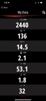

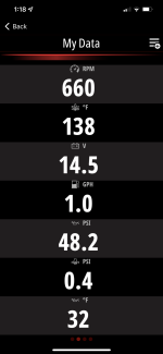

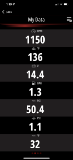

I used the info provided to get other readings from the vessel view. I have posted them below. To be honest, I have not researched what normal readings should be, but any input you have please let me know. The last screen shot is right before the boat when into guardian mode.
nola mike
Apr 22, 2009
5,756
I'd be interested to see spark advance pre and post guardian mode at similar rpms. Most of that info isn't particularly interesting. What's the value below oil pressure? Water pressure? Was the boat warmed up? Water temp is cold and didn't rise.
