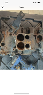

I’ve seen a 4 hole version of this manifold also. Was on a Volvo penta 4.3 motor which was more of a dual plane longer runner design. I’ll try to find it again and post picture.

Just says marine high rise but has egr which is Odd. It’s a lot taller then what’s on this boat but can see it’s dual plane.

Its definitely not marine. Probably from an 85 or 86 gm truck which are just about the only carbureted 4.3 applications.
