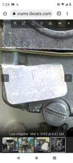

What numbers are on the tag on the upper carburetor ?----What number is on the high speed jet ( orifice plug ) inside the carburetor bowl. ?-----Carburetors do not appear to have slow speed mixture adjustment feature.----The idle air jet seems to have been tampered with and abused !
The tag say wx 338511
38,772
I believe the motor is NOT running on all 3 cylinders !------It sounds awful to me.-----I am not looking for the number of the carburetor bowl !!----Read carefully-----The number on that metal tag is ???----The number on the high speed jet ( orifice plug ) is ????----Read the questions and answer if you are looking for help.----Do some trouble shooting .----Do not run engine the way it is now.----Find out and correct what is wrong.----Install a new impeller before launching the boat again.-----Good luck.-----I think I might step aside for now.
Sorry for not knowing what u was asking but thx anyways I did post a picture of the tag
It was 115833
38,772
.I see 2 different numbers posted for that tag----I can not put my hands on your motor.-----Compression seems low.----Test with another gauge.---Good luck with it.

The carb number he wants is on this tag.
