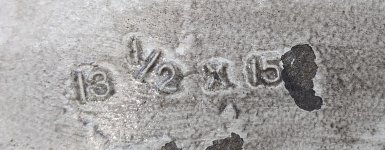

Yeah, the local shop wants $250 new and $100 to $150 used - depending on condition.
I took the prop off today and the shaft feels nice and tight in the lower unit - no play at all.
But the prop has some play on the shaft itself - the fit is somewhat loose.
I guess I have a 13-1/2 diameter by 15 inch pitch prop. 13 spline shaft.
It says made in Japan and looks original to the motor.
My use is a fishing boat, I don't care for speed. I'm more concerned about not putting too much of a load on the old engine and being able to keep all my gear loaded up in the boat, along with the 4 of us fishing.

With that much of a load then a 15p replacement would be a good choice.

A quick internet search of your motor show rpm range to be 4800-5300. With your anticipated load of 4 buddies on board you want that zuke turning around 5300 when lightly loaded. That should put you into the sweet spot when fully loaded. A tach is essential when trying to dial in a prop. With the prop as damaged as yours I wouldn't run the boat again until another prop is installed.
