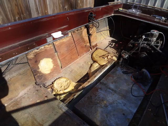

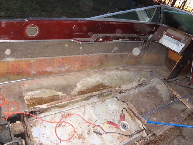

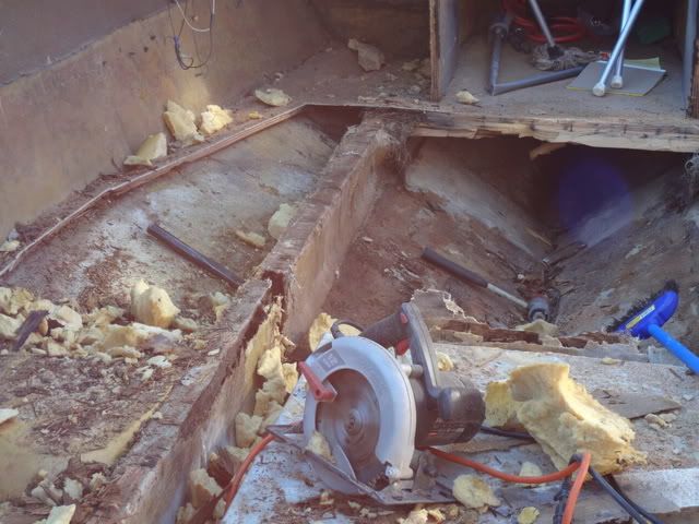

I started ripping up the deck today. Taking a little break to provide an update.
Used my circular saw, set the depth to just over the thickness of the plywood and fiberglass overlay. Got as close as I could to the hull where it rises up the sides to the cap. (not sure what the correct terminology is)
Then made a few cuts at 90 degrees to make it a little easier to pull up the sections. Worked out pretty good. I have included some pics below.

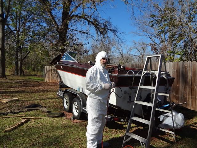

I was not certain I needed to be this prepared for what I was about to start, but better safe than sorry I always say. (Yes I used a respirator/goggles and a second pair of gloves)

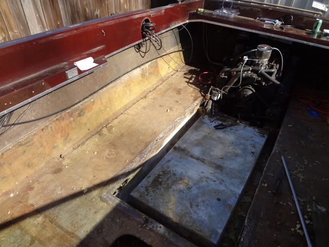

This is before I started cutting. Notice I finished picking up the foam around the tank. I really need to pull the tank out but have to empty it first, is half full, or is it half empty?
The decking here was really not all that bad, just a hint of starting to rot around the edges. The pockets could have used more foam in my opinion.

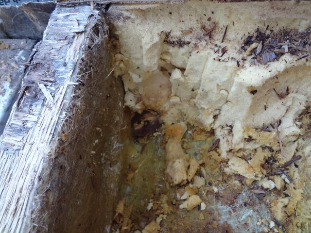

After closer inspection I am thinking this was the spray foam, not the pour type. Two blobs about the same size. I am also seeing evidence of previous repairs.
Foam on portside seems more abundant.

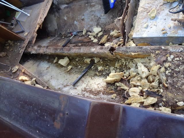

You can see that a bit closer to the bow there was more rot, on deck and the stringer. Pics in next post to show what I found/suspect.
Same goes for starboard side.

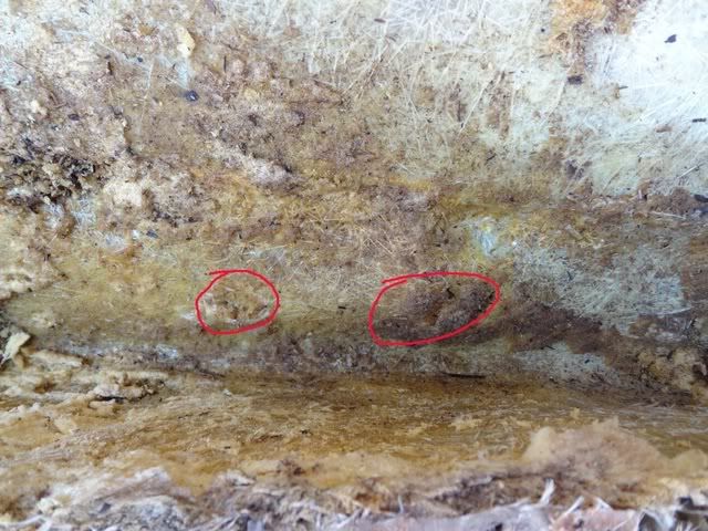

As I was taking up the foam on the portside I noticed it was quite wet. After getting to the hull I noticed some raised fiberglass. Could this have been a hole that was repaired? I propbably won't know for sure till I get to sanding.
Notice how the stringer seems to be leaning towards the camera?
Different angle, seems the fiberglass on this stringer was sagging to me.
I won't take off the stringers till I get that tank out of my way. When it comes time though, would I be best to cut/grind them out?
If the stringers are good wood further up should I leave that or just take them out completely and start from scratch?

Trooper, looks like all pour in foam. You can fix the voids when you go back and re deck her ;) The foam is probably waterlogged at the bottom of teh deck looks wet which means it was just a matter of time before it rotted out. it could have been a hole, only one way to find out!!! :eek:

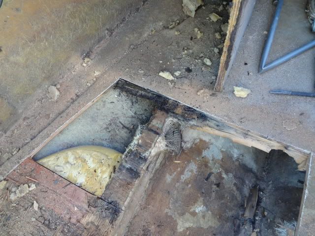

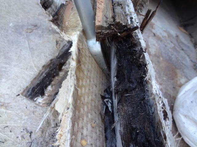

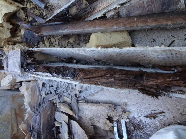

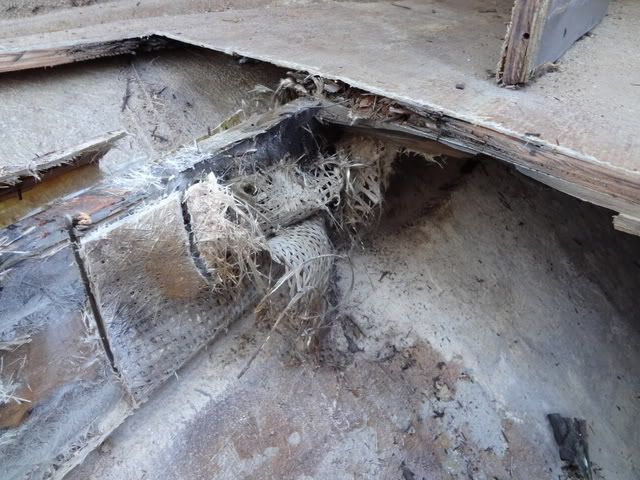

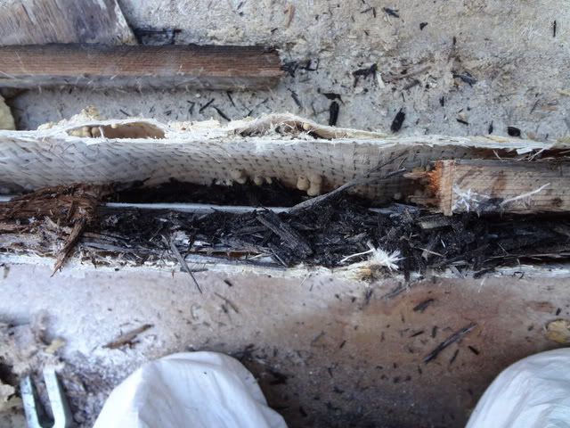

Had to run into work, so late getting these latest pics posted.Here I pulled the top cap off the portside stringer, something looks odd here doesn't it?
Why does it look as if the fiberglass has never touched the stringer?
Here you can see the 3/4 x 3/4 piece of wood that was at the top of the stringer. This was dry, the other piece is gone, dry rotted.
Close up
This is how it looks towards the bow on portside, There is a little resin in the fiberglass here because it is stiff but not fully saturated.I hope I can do better than this!

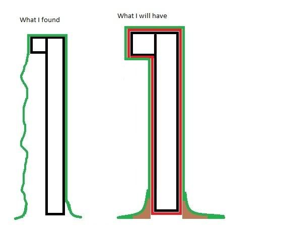

This is how both stringers currently look. Am I correct in thinking I need to have 2 sheets of plywood sandwiched together for the stringers?
Anyone know why they would have done the stringers this way? I was wondering earlier why they appeared to be wavy/droopy...now I know.

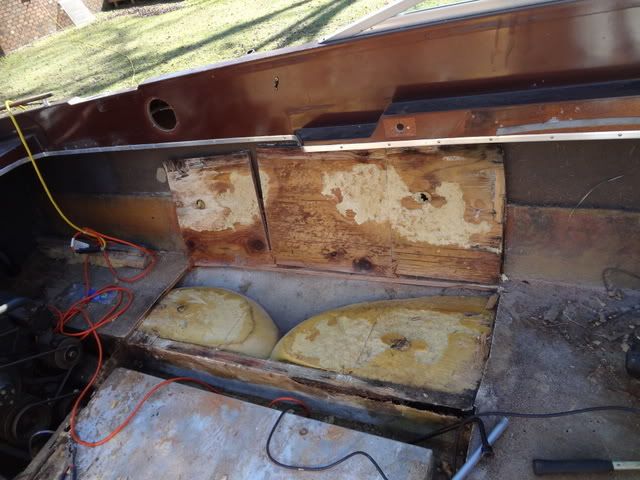

More from this evening...
foam is really wet towards the stern.
This is how starboard looked after today.
And port...
The port side of the "V' there where the ski locker was is very soft compared to the starboard side. I put some weight on it tonight while putting the cover on and noticed it was flexing quite abit. I will work on getting some added support before going any further with the stringers. ( there really isn't much there to call a stringer in my opinion)

the reason for the floppy fiberglass material is just a bad choice of materials combined with a bad glassing job.
the thick woven roving (the material there) does not like to go around sharp corners. that , combined with not enough chopped strand matt, caused the thicker glass to pull away from the laminate right at the point of glassing.. instead of cutting the glass to make a proper lamination...they just left it.
you , can do a much better job with more advanced materials, and a little more care and attention to detail.

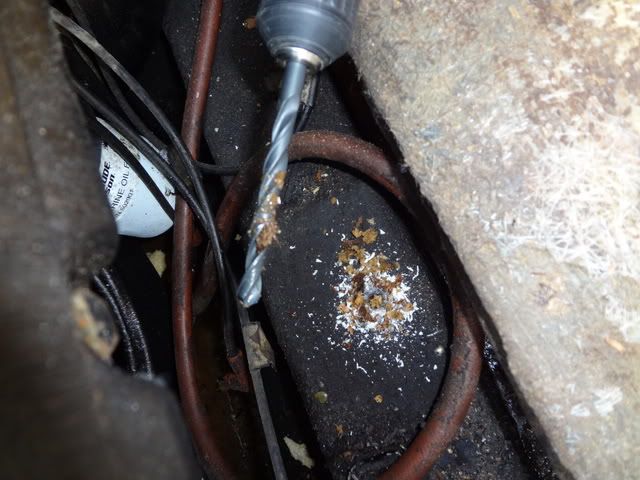

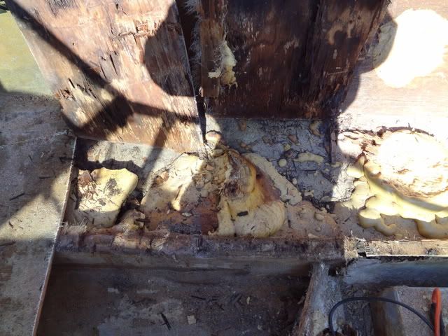

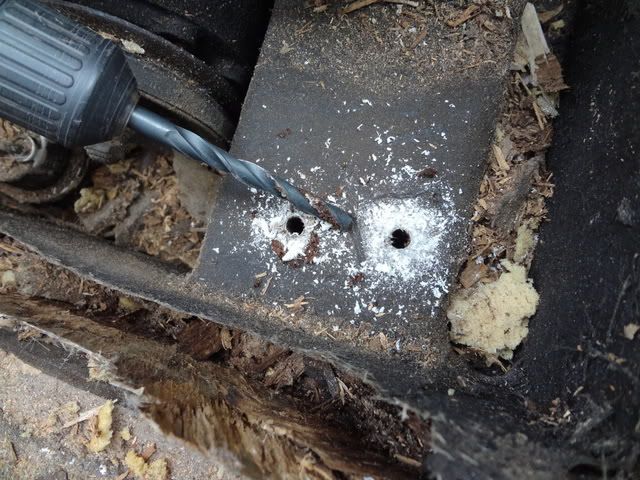

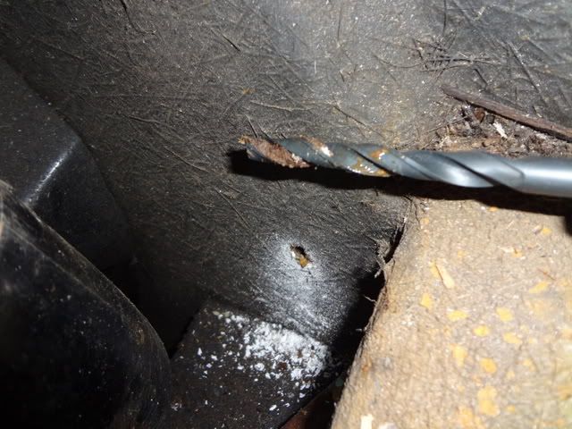

Weather is not going to cooperate today. As you know I am forced to work outside so if mother nature feels weepy, I cannot do much for now. I did manage to get in the boat and take some samples of the motor mounts and transom.

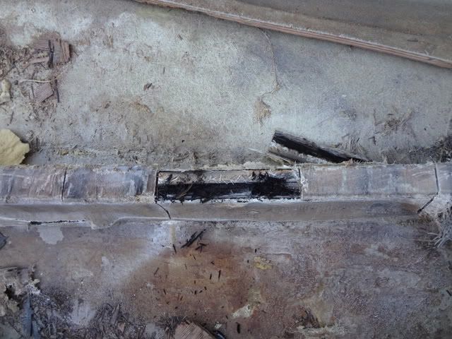

The portside motor mount felt hollow once I got through the exterior fiberglass. Drilled twice to be sure.
Further back on motor mount not hollow feeling, but as you can see very wet wood.
Transom, just above the motor mount - wet wood.
Stringer near motor - mixed wet/dry wood. This is due to the previous repair that had been done on the boat - see pictures in post #35.

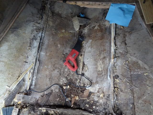

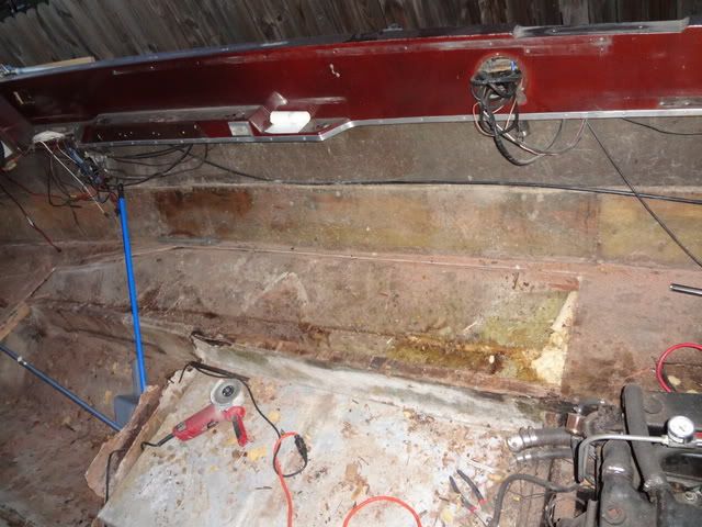

Mangaged to get a little time in today before the rains hit again.
Next 3 -5 day will be rain they say.
The wife got me an early christmas present. I am thinking the starboard stringer might not have needed to come out? There was evidence of rot at the top of this stringer.
Question for the pros.
Stringer material - board or plywood? Noticed the boat had both, the board is from a previous repair.

Most here seem to prefer plywood.
