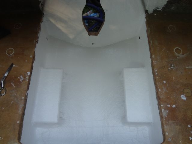

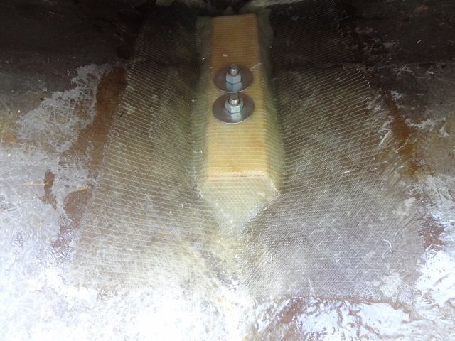

If you have been keeping up with me and this thread...you know I can't sit idle on a day I could be working on the boat.....so.......
I need the bow eye to do the flip when the time comes...so put it in temporarily...
Might have jumped the gun, but I can't stand to sit still.....
This is two coats...second with wax..Hope it isn't too thick...I have no idea what 15-20 mils is in inches...guess I could use google to find out though :)
Edit: Come on 15 mils is .015 (15 thoudsands?) I know what that is....never knew it was that easy to convert...shees learn something new everyday!

Re: '78 Ebko Lebaron - Therapy
I did the same thing installing the eye temporary I later drilled the hole bigger installed pb then drilled the correct size hole.
BTW I think your about .001 mils to thin on the gell better put another coat.. :D
I was thinking it might be 1 or 2 thousandths thin as well. So suit up & find the Admiral's mixer, we're burning daylight around here:eek::facepalm:
Eye looks good, esp for temporary! Another great day boat building at the Trooper boathouse!:)
You both were close....it was actually .0015 too thin...have made adjustments :)
Not much to report tonight..I got 3 of the 4 drain tubes installed...
Didn't see the need for a pic...seen one drain tube you've seen 'em all
Looking at the bilge area after getting the 2 coats of gel on it...I see that I really should have done some sanding before putting the gel coat on...but this is a pleasure/fishing craft....not an antique classic...so I think it will do....just mentioning it in case someone else gets in a hurry like I did...
A few outings or a season or so &
'Smooth pre-gelcoat bilge' What? Will be all that comes to mind in the 30min you're changing the oil, or the less then 1 min the doghouse is open to turn the battery switch pre-startup at the boat ramp.
Well that & the 0.0015 missing topsides of that bilge gelcoat:eek: If these items haunt your dreams at night, you are not taking the correct prescription volume of your favorite frosty adult libation:cool: Find another, open, consume & repeat as necessary.... While we're talking haunted dreams, Where ya putting the battery(s)?:) Oh, and the iBoat's nation never sleeps & we are watching you & your progress!:p For now you're good..

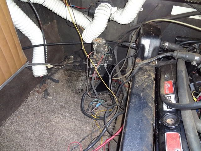

OK JB, I get it....putting too much thought into it....:)
Batteries...they were in the rear port corner...thinking they will go back there....and that reminds me...the trim pump was on the opposite side...it was leaking...I need to look at that...
See..you done went and gave me a project or two for the weekend...thanks buddy...no, really thanks...I needed something to do...was going to go crazy without any resin and not having anything to do :)
Troop are you going through resin withdrawls ? Hey I know the feeling I have been nit pickin my boat all spring and up to this point seeing how the Army corp has drained my lake to help the Ohio river again! (tributary control basin). If I had more funds I would be re-carpeting the deck. By the way most trim pump leaks are from the seal around the pump on top of the resivoir. By the way that bilge looks good to me.
Yes I am!
Thanks for the tip...I may end up painting it too...it needs it...
I don't know, Troop...a bilge that you will not be able to polish and see yourself in...pretty poor attention to detail...:facepalm::rolleyes::p...LOL:D
But, seriously...that is one awesome milestone! Getting the deck tabbed in...man, I can only dream about that for now...
Way to go!
Now don't go getting Jas Battery placement syndrome...
Keep up the incredible progress!
Tabbing complete!
SP - No fireworks near the boat, the acetone, the resin......period :)
Hey Trooper, read the entire thread , your doo great and looks like the work on the inside is getting close to being close to being interior time.
I did have one question, i noticed the you fillet'd the back deck with PB, but did'nt see any on the mid or front, just the tabbing. Is that correct?
