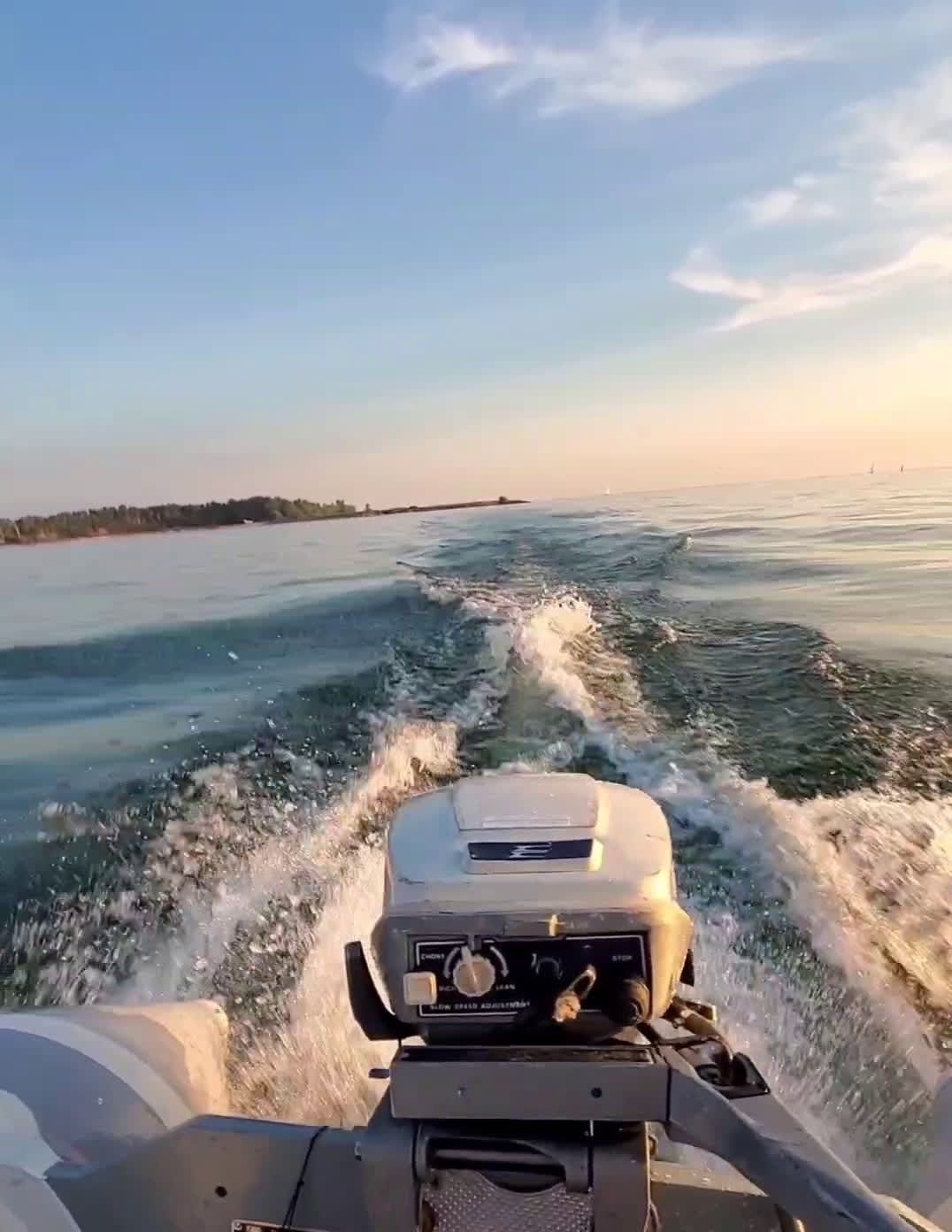

That makes sense because the impeller RPM is dependent on the motor RPM. When there's more pressure, there's more water. The stream should get bigger and shoot out further back the more you open her up.
Just wanted to thank you OptsyEagle for sharing your experience and knowledge. The knowledge you're sharing will help many new users for years to come.
Here's a video going top speed:
