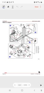

The first thing that comes to mind is the drop in voltage with the key switched on. I'd be looking for something shorting out the electrical system. Maybe get the wiring diagram for the engine, if you don't already have one and start chasing the circuitry. It's got to be a pretty hefty current draw to bring the voltage down that much. Maybe with an IR thermometer, look for the hot spot in the wiring. :unsure: Got access to a thermal imaging camera?

I have it but it's so confusing and hard to discern.
