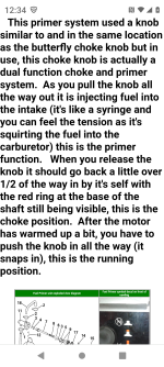

A little more info, you say 1984 30hp Evinrude (25 cap) is there a model number on the clamp? You say choke plate has been removed. That should have a manual primer system....is it there? Your problem could be there. Here is a description of the alignment ring and the most common things that go wrong when you have a upper end surging issue. 8th spot down in my omc service book.
Didn't use the omc tool for setting clearance. I did set clearance very carefully. By putting flywheel in place and adjusting both coils one at time until they cleared( barely clear.. but I know it's not the same as a set clearance. )
I will get the model number and take some pics tomorrow. I honestly didn't even think about the manual fuel primer. ..
Maybe it's allowing extra fuel in intermittently..idk.
