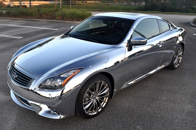

I saw this vinyl wrap on ebay and wondered if this wouldn't be a better choice to polishing. I've seen a lot of cars done with the vinyl wrap material, and was wondering how durable it is.

I used some of this vinyl wrap in carbon fiber on the Holiday dash, and honestly don't think it would stand up. Bunks would snag it and rollers would over-compress it like what happens to a keel guard. If you got stone chips in it I think the water would get under it and lift it.

Glen, I think you're absolutely right on the bottom of the hull, but I look at how well the ~4" vinyl pinstriping on my SS held up over 27 years, that stuff was a real bear to get off using a heat gun and razor, so I think this might be good on the sides above the chines, but normal wear and abuse would probably also prevent it from being used on the bow. Maybe better for a color than for the chrome look.
