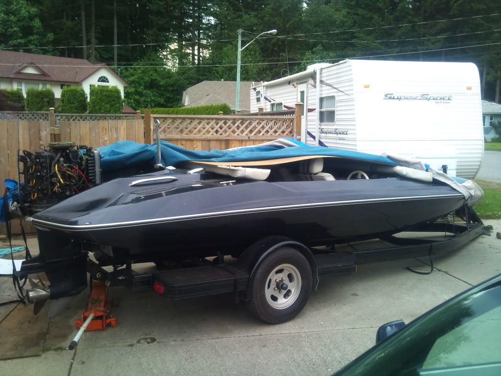

My motor runs fine out of the water with the muffs on but when i put it in the water with the motor all the way down it idles a little lower not a big deal but when i put it in rev it realy bogs down and wants to die if i back up for 30 sec it will flood out and be hard to start after. after backing up for a bit and then start going forward it is a bogs a little out of the hole but then runs fine and then when i come to a stop and let it idle runs good hit it again and it takes off. if i have the prop just under the water and put it in rev it runs alot better i can back up for some time with out it wanting to die.the poopet valve is weeping a little water out of that little hole in the cover not sure if that would cause the problem i am having. i have changed the plugs t-stats water pump the oil system was taken off by a prev owner so i mix the fuel 50:1 with mercury prem oil. there also is some oil below the carbs on the cover. my dads boat guy said there is a ring or plate inside the prop that stops the exahust from going back up into the motor cover while in rev but i cant see what he is talking about. i am thinking my next step it to pull the carbs off and rebuild them any thoughts??
