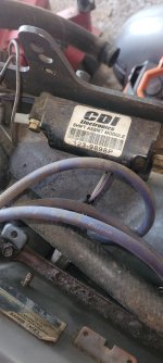

This engine came with the CDI shift interupter on it, is it a good unit or should I use the OEM setup. I'm sure there are pros and cons to both, concerned about dependability.
