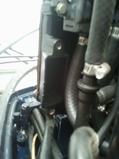

I did a little research and it appears im missing the extensions from the intake silencer on both sides. Will this cause any loss in performance or do some motors just not have them. Attatched are some pics of what I'm talking about

Can't answer your question about what effect that would have but those screw holes look like there was something bolted on there; I would go back to whoever did the link/sync and get those extension/covers put back on. My 150 covers point backward toward the rear of the engine which is where the air intake of the cowl is located. Good luck.

The extensions were actually missing before the link and sync. I just never thought of anything supposed to go there until I was looking at a parts diagram.

I'm missing the extension on the port side of my 1988 110hp and it doesnt seem to affect anything.

They actually quite the engine. i have them on mine (140HP) and i take them off to do any work and i notice an audible difference as soon as i put them back on it quiets back down.

Probaly a good idea to have someone check the sync and link again. Your high rpm loss indicates something is out of adjustment. Make sure the carb throttle plates open fully at full throttle. You will have to pull the airbox cover off to check this. Those side extensions on the airbox do help silence the carb noise. Also, they slightly richen up the carb mixture due to airflow changes. Running without them may not be a problem, but it will run slightly leaner without them. If you still have them, it's probably best to reinstall them.
