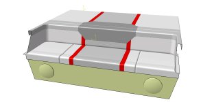

The upholstery is also going to need attention soon so I've been doodling up new designs. Working in engineering gives me access to CAD software, so...
