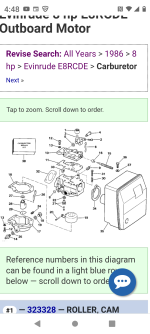

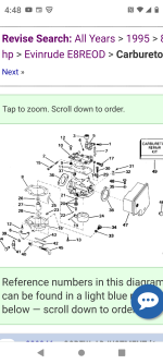

I think your going to find a lot of differences between the 86 carb and yours.
I think the year the seller listed must be wrong. The main reason I bought it was after seeing the part # on the plastic top plate is identical to the one on my carb, and everything else looks identical, minus the choke thru-pin.
Here are some pictures for comparison:
My carb:
Carb I bought off eBay:

Maybe, it has the rich/lean screw on the right side like your old one. 86 was in the front.
What you hope now is you don't have two crappy carbs!
