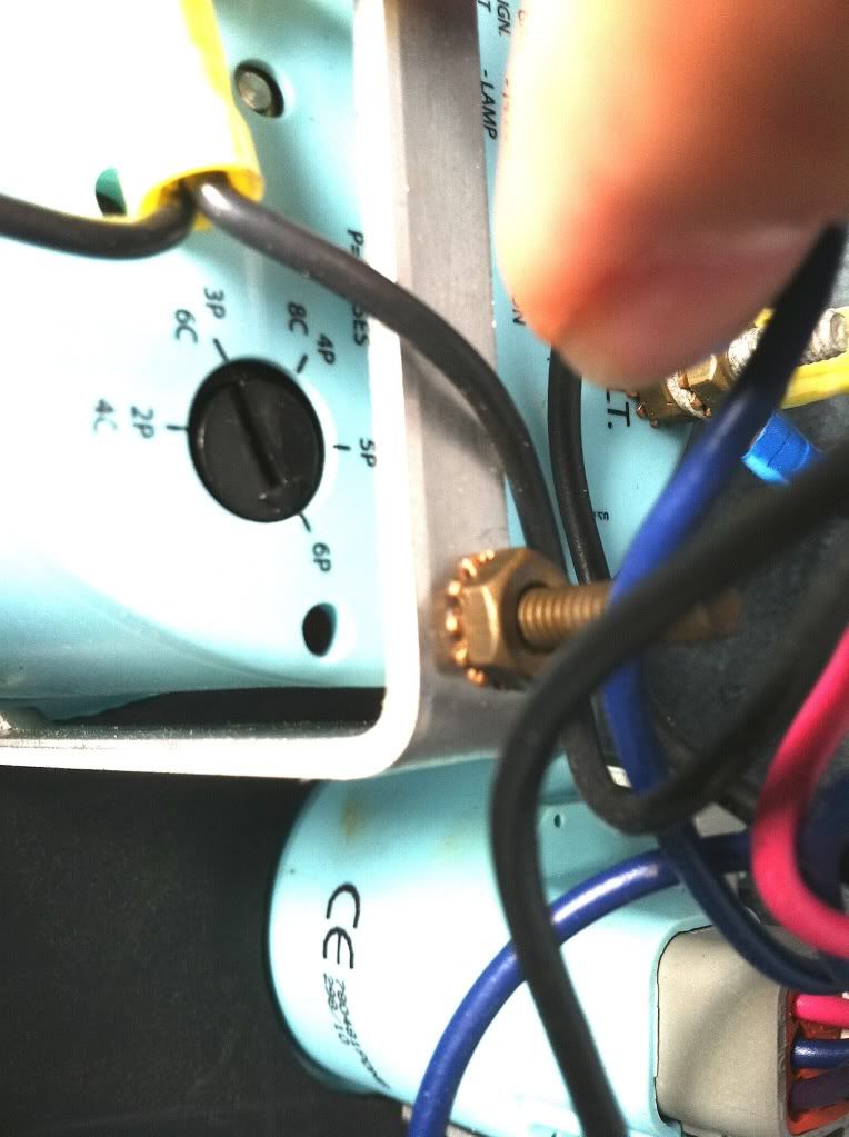

heres a pic of the tach is the pulse set right? looks to be a arrow pointing at 6p???
